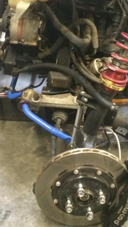

      e36 m3 front sway bar with stock end links. End link tabs moved a little bit.
        Everything bolts up with minor mods?
        • nando
          • 34844
          On an ix?

              They do look fairly similar.
              AWD > RWD
              • nando
                • 34844
                Ix bars have a bend to go over the cv shaft.

                              Yeah. E46 323i didn’t work. Going to try e36m3 next. Here’s a iX with a e36m3, I couldn’t talk directly with owner on if the mounts or bar are custom but you can note the sway link mount location.
