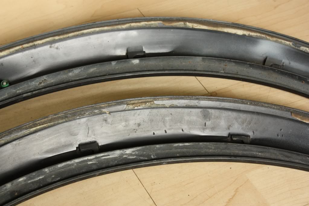

        Do you have a pic of the inside of an ix flare? we never got them here in AU so i havent played with them. If there is a thick enough edge (10+mm) you could sikaflex them on, then once cured run a small bead of sika in the crack.
        You can then clean excess off with a rag and some prepsol (not sure of US / UK equivalent) and once you are happy with the thickness, use a rubber glove and some water, wipe over the bead to give a flat neat looking seal between the two parts.
        Post a pic of the inside of the flare if you can

          Busy few days and only getting a pic up now:
          Looking at it and not being to keen on drilling holes in my arches for the green grommets, I think a bead of glue/sealant where you see the tape along with a bead where the grommets are and then stick it on with clamps to hold it in place. Not sure how long it will hold but worth a go anyway.

            I'm pretty sure Nando just holds his flares on with double stick tape.
              The foamy kind of double sided tape? There's some of that left on it, if it does the job I'm happy :)

                Yeah the auto double sticky stuff. Just shoot him a pm.
