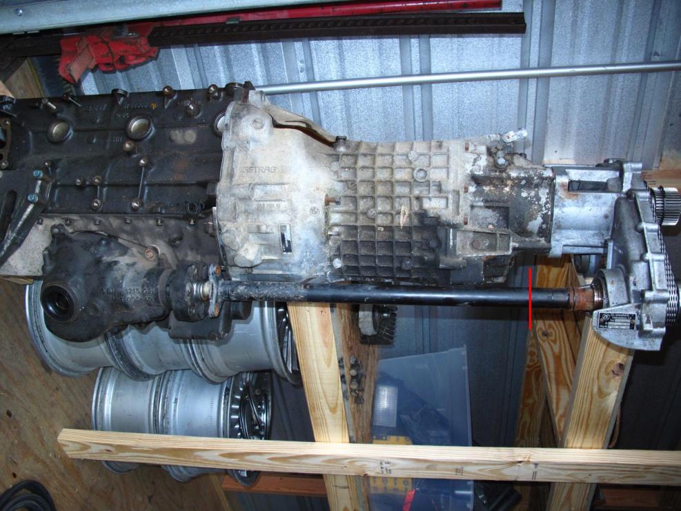

    So this is where we should make the cut? On the drive shaft only of course.
    • DRTSRFR
      • May 2008
      • 1836
      #167
      Yes, cut right behind the weld.
              Line those O-ring grooves to same. welding comes nice together if you make V-groove for the weld.
