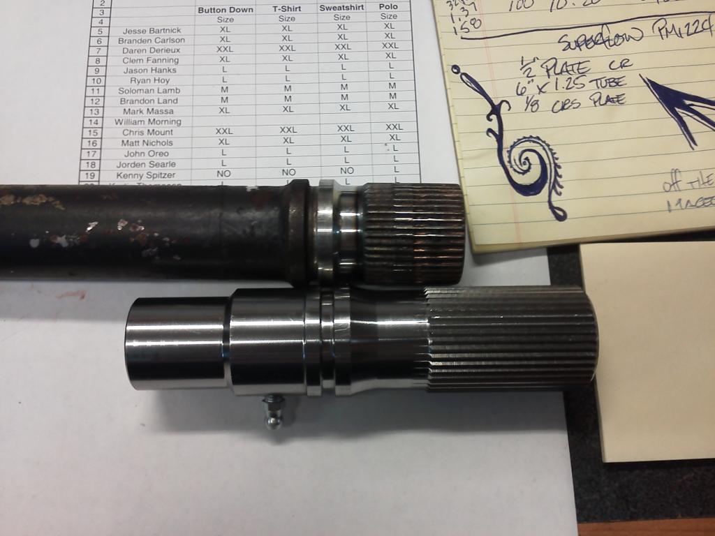

                  #158
                  Sadly, I didn't take pics.
                  Fortunately, I now work in the machining industry, and the fix was simple. A friend of mine did his three weeks ago and had the same issue.
                  Mine is an automatic. Is it possible the manual version is different?

                    #159
                    I just pressed mine in. I think it was intended to be size on size so you didn't have to worry about keeping the head aligned while welding it to the shaft.

                      #160
                      Not the best pic, but you can see the OD of the shaft is very similar to the OD of the stub.

                        #161
                        Yeah I've got one feedback about the different sized shaft.
                        The one I've made has 30mm inner diameter and the different one has around 27mm... dont know why?? someone guessed that there would be early and late shafts but I think it would be the automatic..? does the automatic transmission have torque converter? IF it does, it will need stronger shaft because it makes more torque.. this is what I think..

                            #163
                            Great theory, but mine's an auto...so is my buddy's.

                              #164
                              yeah had to have jute's insert shaved down to fit into my donor shaft (not sure if the donor one was from an auto or manual). Didn't know they were different.

                                #165
                                it's the same shaft between auto/manual. my car was originally an automatic. I have heard there are two sizes but I'm pretty sure that's early/late, and they are interchangeable anyway. I've had like 5 different shafts and I've never seen the different one.
                                they aren't, but it's not clear exactly what models came with the thicker shaft. it could just be the manufacturer changed at some point or they used a different material that didn't need as much wall thickness.
