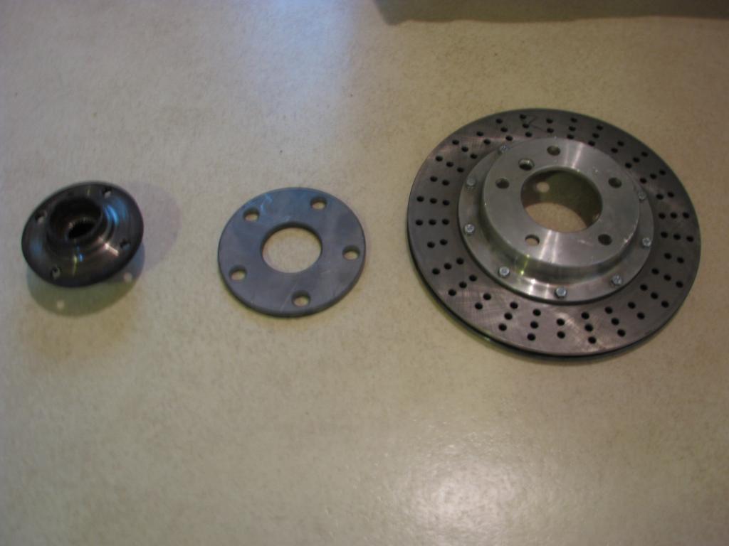

      Here's what i planned first..
      Toyota hj61 front disc with billet center... Im still wondering if i just replace old bolt plate with new one... welding it together, but i think its to risky... now when i can, i might do billet hub instead :)

          I readed about it on finnish forum. e87 116ti rear hubs would fit to front
          of ix, but they come 9mm outer... using e30 325i rear hubs on the rear would lower offset 15mm= more lip to wheels! 8)
          Need to find out that e87 hub, if there is possible to machine them to same offset with e30 ix
          is there shop that makes 5 lug pattern for e30 325i? so the offset would remain?
