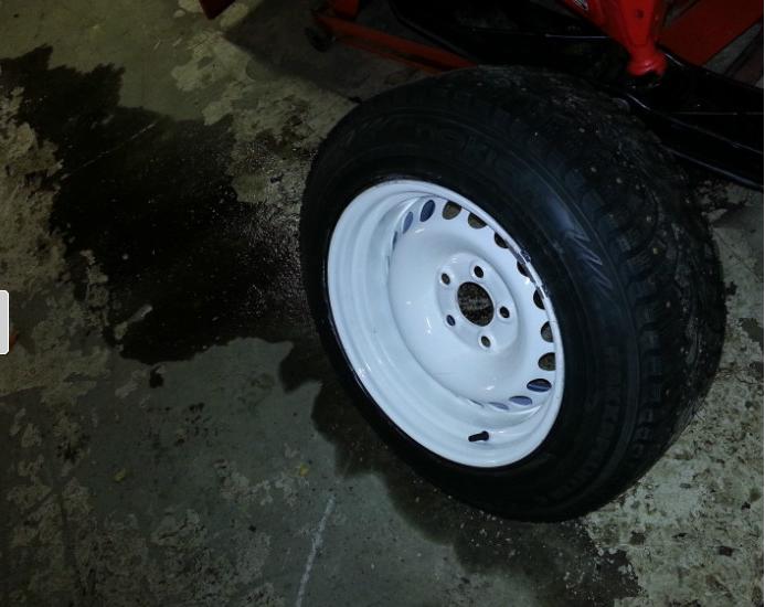

                          well it depends of wheel, usually cast aluminium wheels weigth something between 5-10kg each, with forged rims you could go around 3.5-5kg... we have quite lights steel rims here.. homemade 9x15 steel rim

                            and if you use car on the street, does the weight really matter? do you go to shop and ask always lightest wheels? nope, i prefer look better...
                            with steel rims, you can make as wide as you want and choose you offset...
                            that gives you perfect fit.. im going to make steel rims 7 wide for winter and give it a tyre 175-195 wide..
                            rally look :)

                              Home made Steel wheels are those D.O.T. approved? Legal?
                              There are plenty of light weight steel wheels from Bart and Aero Wheel. but they are not D.O.T. approved or street Legal. Leave you liable for anything that could happen if you get in an accident.

                                I really like the steel wheels, I always wanted to widen some on an old 740 wagon I used to have. Thanks for everyone's help, I think Im going to go with some royal gun metal 15x8 RB's et 35.
