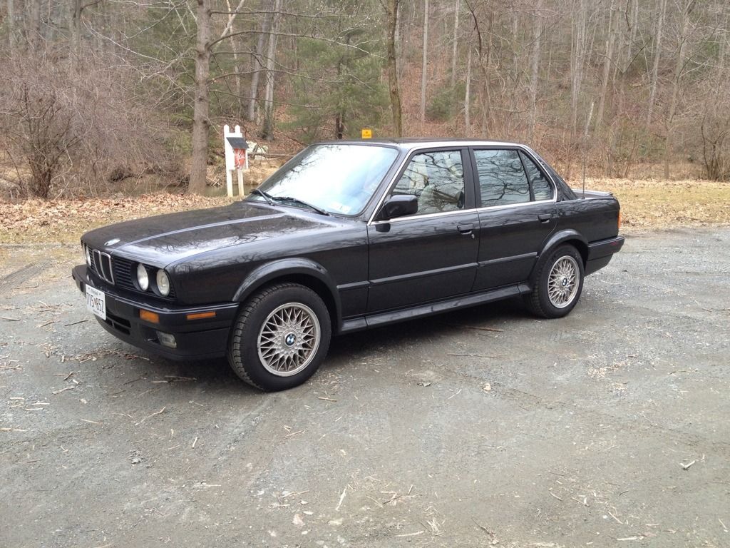

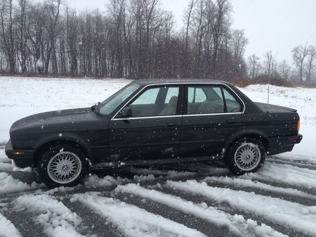

    So I have acquired this during the sale of my e24.
    It is an '89 325ix sedan automatic base model. 164k miles, diamond black over tan vinyl comfort interior, recent replacement transfer case, rebuilt axels fairly recent timing belt water pump and a good set of Michelin Alpine snows.
    This thread is to capture its repairs, refurbishment, my questions and musings.

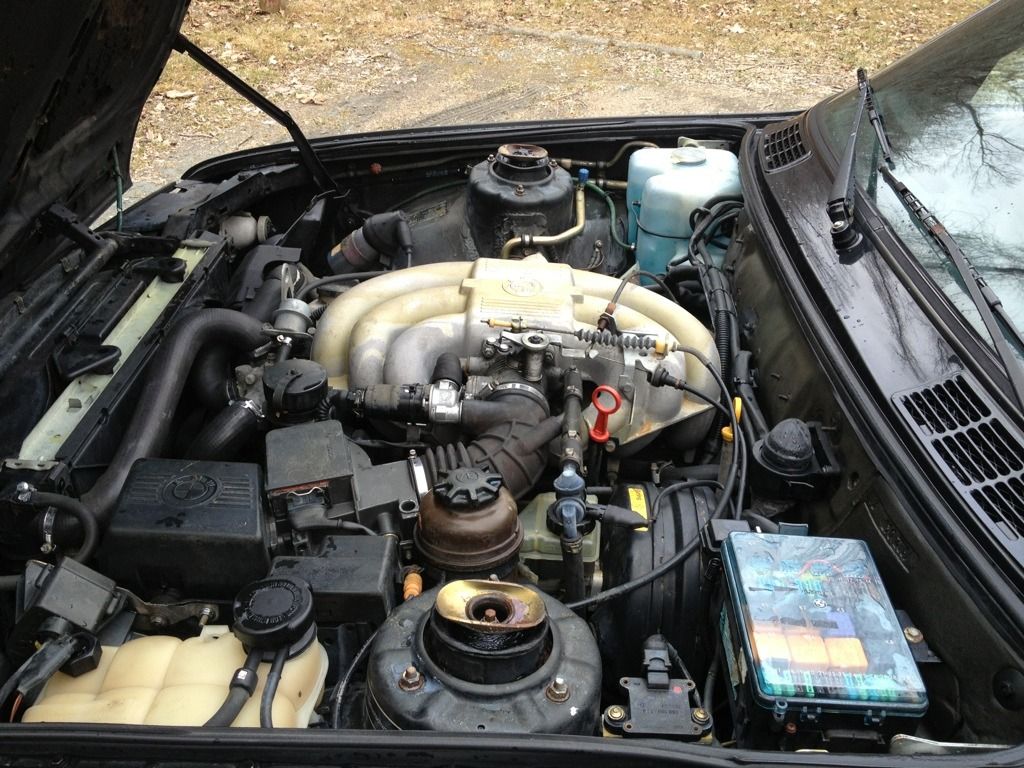

    headgasket (it is starting to weep oil)

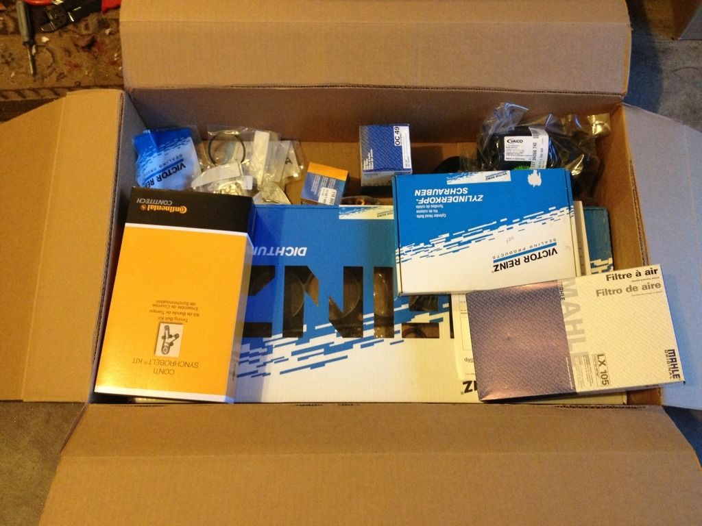

    Yesterday I ordered
    Head Gasket Set
    Head Bolt Set
    Copper Exhaust Nuts
    Spark Plugs
    Timing Belt Kit with Tensioner Roller
    T/belt Tensioner Pin
    Timing Belt Tensioner spring
    Air Filter
    Fuel Filter
    Thermostat
    O-ring
    Thermostat Housing Gasket
    Breather Hose
    Throttle Housing Boot
    Oil Press Switch
    Oil Filter
    Motor Mounts
    I still have a few more parts to order and will be installing new fuel lines and vaccum hoses. Next order will be all of the coolant hoses because they have never been replaced.
    It gets horrible (worse than expected) gas mileage. about 12mpg no matter where or how I drive.

        I have to say BMAparts (who I've been using for years) is just too awesome.
        Order placed yesterday and parts arrived to day.

              What a let down...... We hardly got any snow.
              I did manage to verify the driveline works as it should. I will say I'm pretty impressed when it snows. Too bad it won't snow 300 days a year for my appreciation....

                Think twice before using the Victor-Reinz head gasket. I've used several of them now and they all have failed within months of installation. Check this and other forums for other people's experience with these gaskets. If you are going through the trouble of rebuilding the top end, bite the bullet and use the factory gasket and head bolts. Money well spent, I've been there (more than once..)
                • PorscheDude
                  • 36
                  Thanks, but after 20 years of messing with BMW's I have never had a problem with the VR stuff. I chulk most of these reported problems to inexperiance or improper installation.
