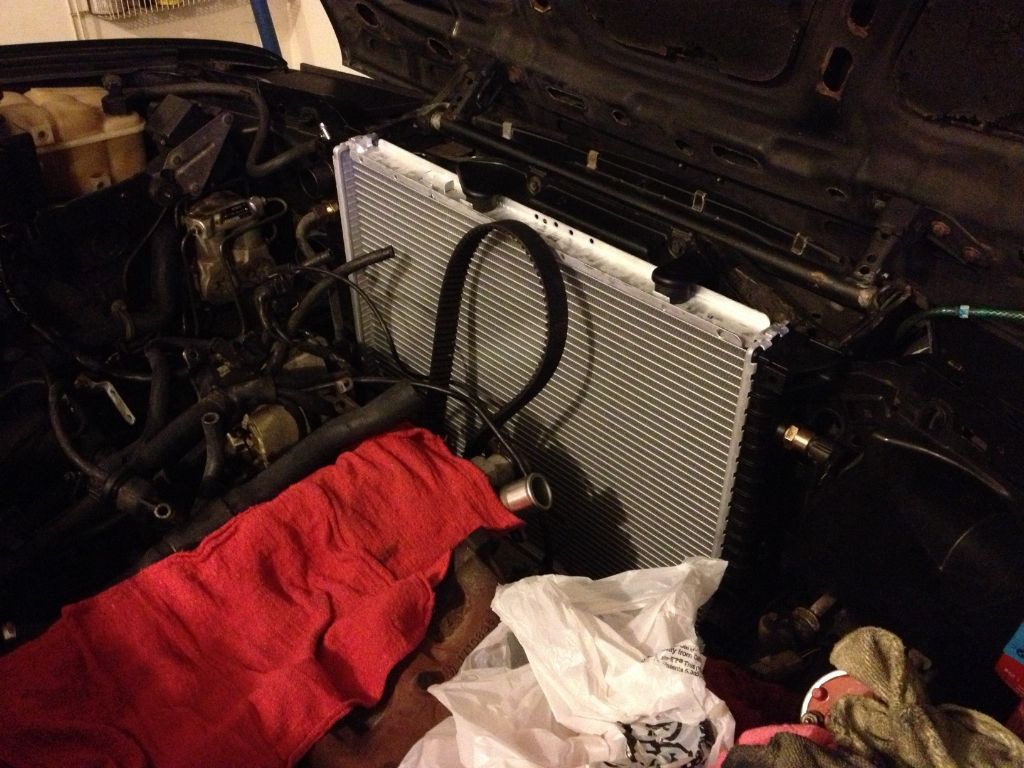

          New radiator, I went with Nissens. I've had better luck with them than the Behr over the years.
          Old radiator and amazingly its the the original.
          New Radiator installed with new fan switch and water pump.

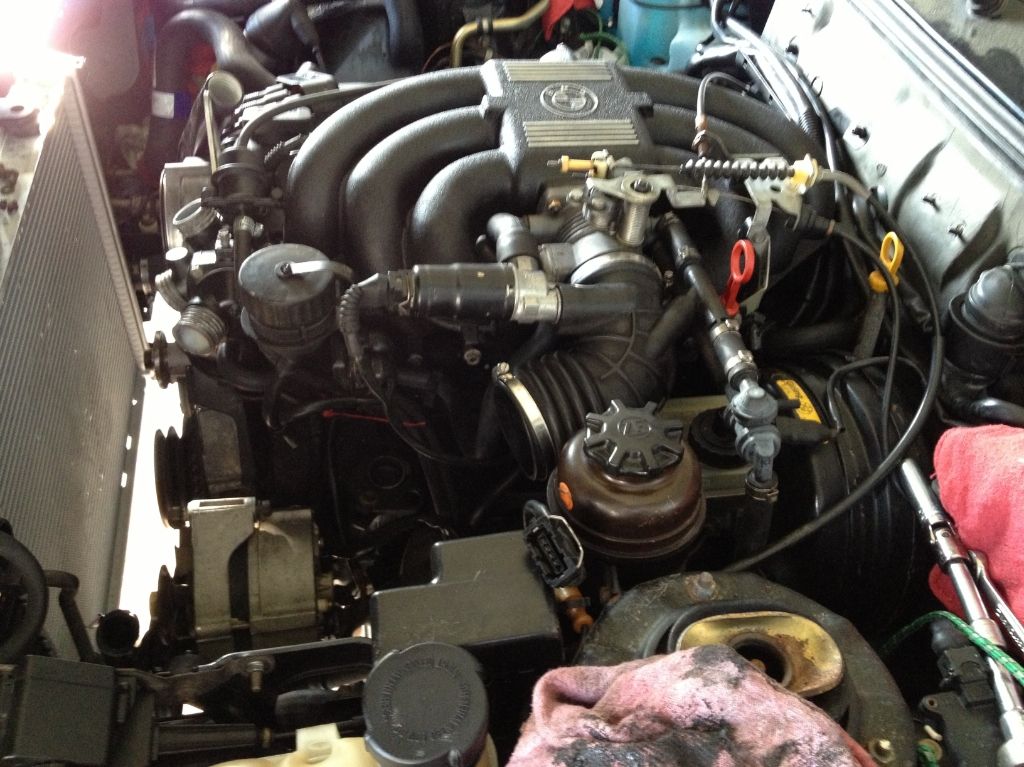

            Got the head on and torqued down using a torque wrenh and torque angle gauge.
            Also got the exhaust buttoned up.
            We'll see if how motivated I'll feel in the morning.

              I managed to get pretty far today. I have maybe 45 minutes before I can turn the key. I just have to finish coolant lines.
              I wish I could have kept going but, I have a bad back and it's gonna be killing me for the next couple days.

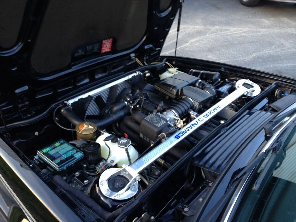

                  It's alive.

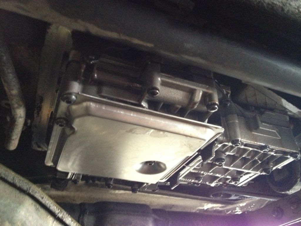

                        Yesterday I drained the ATF and installed a new filter.
