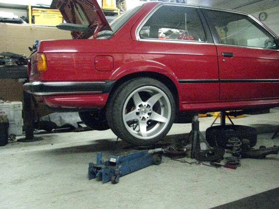

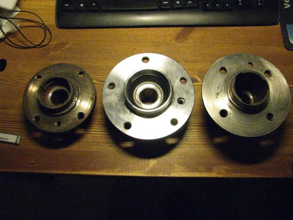

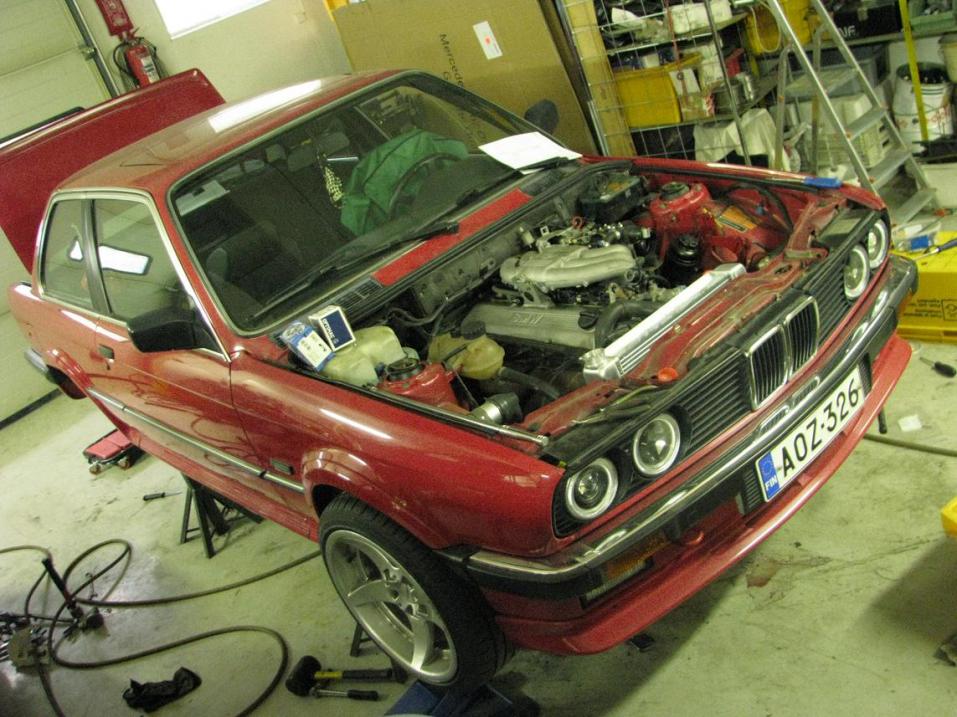

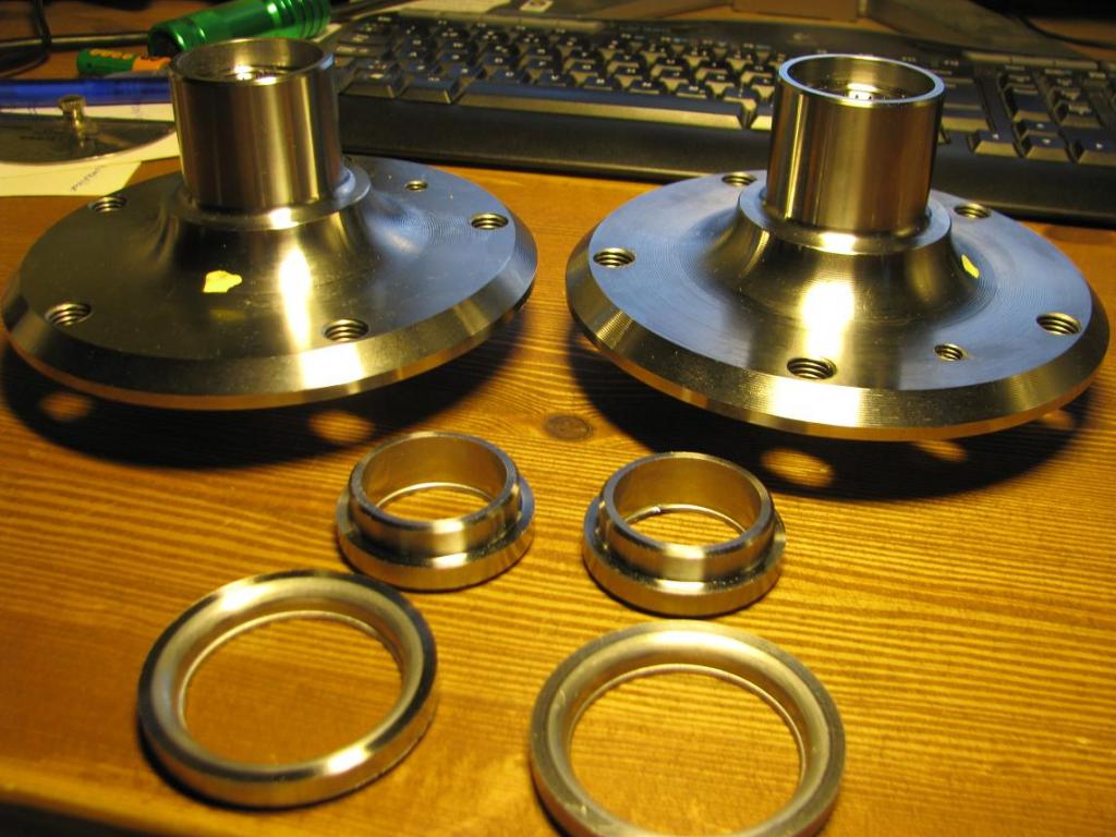

                            • jute91
                              • Nov 2011
                              • 581
                              I have done now 5 lug swap to my -87 ix.
                              Hubs are from e87 116i and they have same bearing size.
                              Rear i needed to make 5,5mm thick "spacers" between hub and bearing.
                              with that mod i am able to use e36 325 rear rotors.
                              Im making center hubs for e36 325 front rotors so they would fit on front.
                              Going to run front 8,5x17 et13 with 215/40 tyre and rear 10x17 et15 245/35 tyre. exactly same size tyres.
