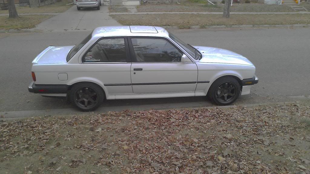

              I am sorry, i have doo this.....
              This is ThatOneGuy97 car, but here is one example
              Varrstoen V1s 16x8 +25, 205/45/16 tires, H&R lowering springs and koni yellow struts.....
              Yes nando has knowledge and experience, that is cood to give advice .... But sometimes considered to break something things.
              I would have believed that those wheels fit below , before I saw your car with those wheels. In here can collect images, tire sizes, wheel sizes, etc. for IX :)

                    • litu
                      • 848
                      Originally posted by nando
                      I think what you're trying to say, is sometimes it's good to try something different. well - how do you think I figured out what exactly will fit without issues? ;)
                      Yes....I like to read your instructions with the thoughts, the instructions + explanations are valuable for me and i am grateful that someone always cope with these same things out, etc.:grin:.
                      But some times some goes nuts and try some different. My wheels problem is now maybe too big, but daunted by me;).
                      Those wheels what I'm trying to under. It would be perfect for stance up if you do not have to but spacer
