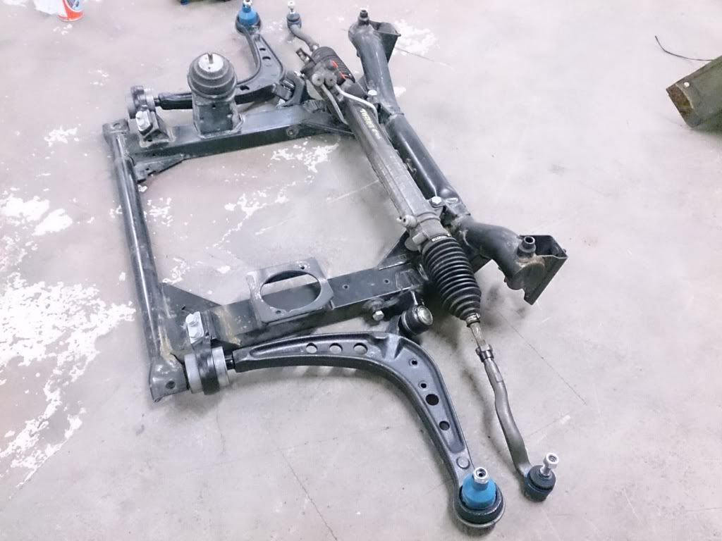

              Been checking around a bit and it seems that the E46 rwd rack fits the E30 rwd pretty much as fine as the E36 one, so it should work with tie rods etc.
              Or you can swap the whole E46 front end like this :D (rwd though)

                E46 RWD crossmember bolts into E30 RWD? wild.
                  http://server.pure-pf.com/phpBB/viewtopic.php?p=405858
                  Yeah, but i dont think the RWD rack will work on an AWD subframe, and it would likely have the same diff clearance issues.
                  Build thread

                    #69
                    There are some mods needed but its totally doable :) Some mod to the rear wishbone mount as seen on the pics etc.
                    Yeah your probably right, hopefully we could get a E46xi to work on ours with tie rods etc since the rwd swap seems to work :)
                    Heres a friend doing a E36 awd compact build with complete E46xi front and M5 E39 rear, not finished but pics might give some ideas?
                    The engine seems to sit further back on the E46 so more space for the diff?

                      #70
                      That's what I meant... the *crossmember* bolts in, but you still have to mod the lollipops or lollipop mounting locations to get them right.

                          #72
                          Havent tested myself yet, but on the pics it looks like the engine can go a little lower/closer to the crossmemeber/steering rack? If it can, would that help out the diff space issue?
                          One other way is to mount the whole front end assembly from the E46 XI :)

                            • nando
                              • 34847
                              #74
                              No.. the oil pan already nearly touches the E30ix rack, it cant go any lower.

                                #75
                                That's why you can't use an E46 xi oil pan in an E30. It puts the diff too far forward.
