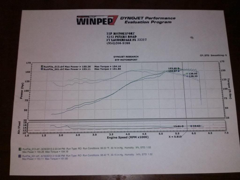

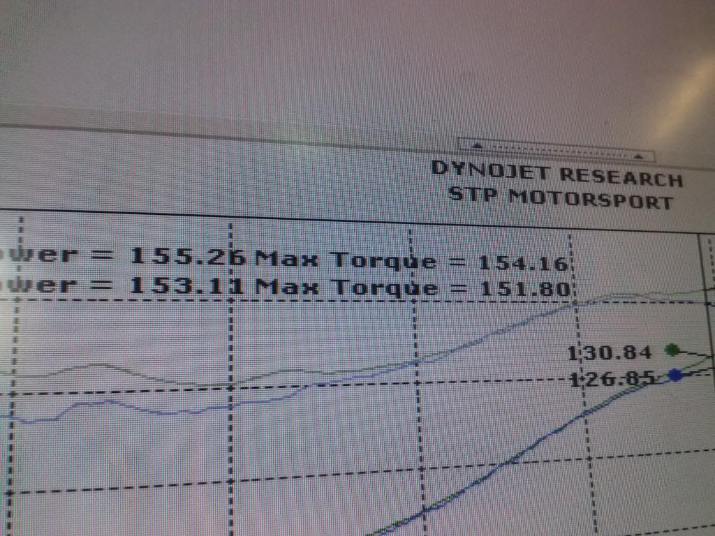

                          Originally posted by nando
                          Id be impressed if you break 150whp on a dynojet
                          Not sure about with the Miller stuff, but I just got well over 150 with RD headers, one of our stock rebuilt heads, and our dyno chip tune. No porting, stock AFM etc. 200+k mile bottom end RWD e30, so an ix will be lower.
                          EDIT: 155.26whp/154.16wtq as you can see, the chip was only worth about 2whp/3wtq.

                          • nando
                            • 34844
                            Yeah but this is an ix, that puts down maybe 140whp stock. Eric Johnson's only put down 125. I saw a 3 liter IE Stroker do 150 (needed a tune, but still).
                            20Whp is just nonsense. That would be ~200 at the crank on an otherwise stock motor. It doesn't pass the BS test.

                            • ForcedFirebird
                              • Feb 2007
                              • 8300
                              Yes, my point exactly. I have tuned numerous cars on the dyno, we have thousands of graphs just from this year alone, the only time we saw any kind of big gain was on my personal car which went from 124whp to 148, but that's because the WOT switch on the TPS is broken and instead of changing it (being lazy), just tuned it out lol.
