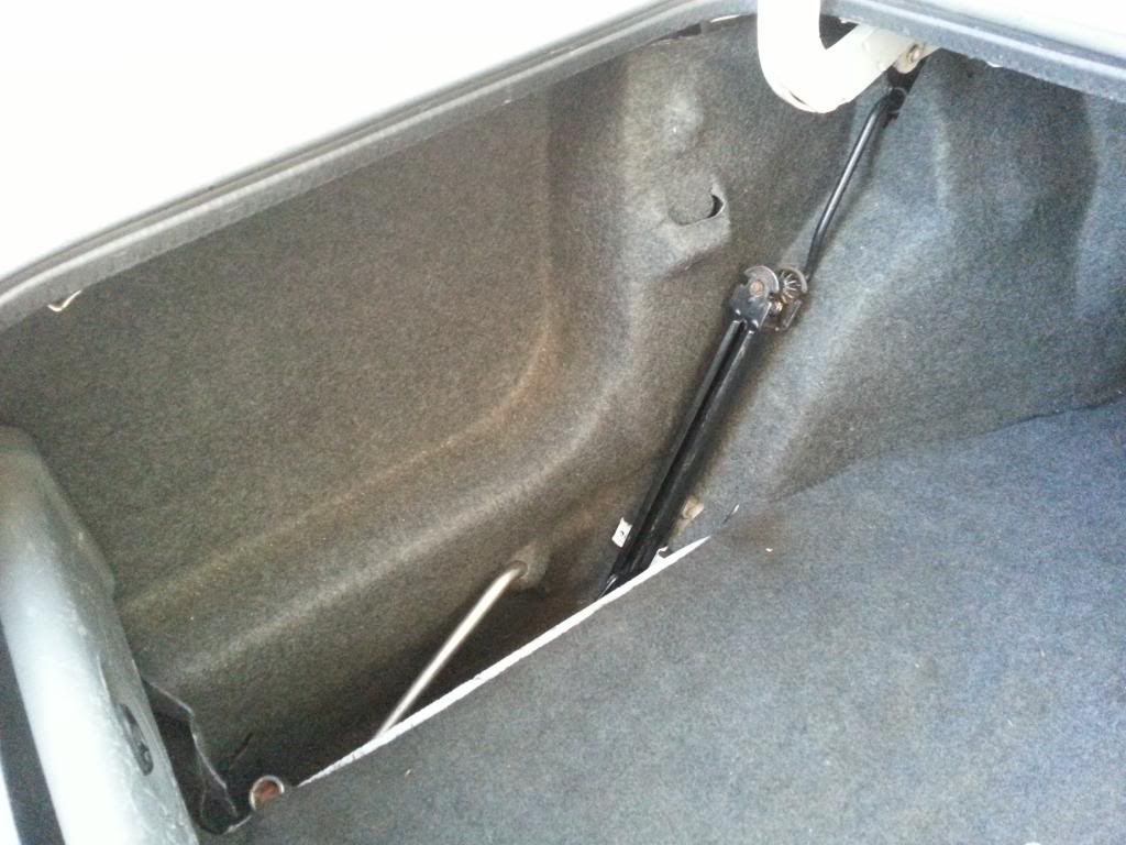

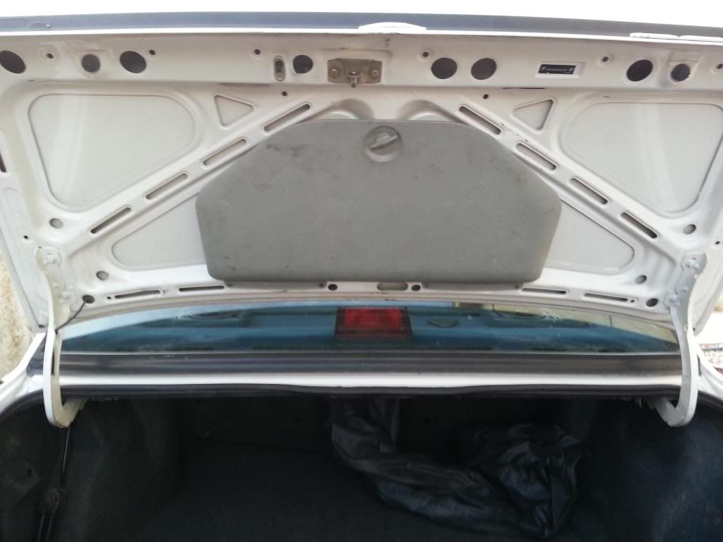

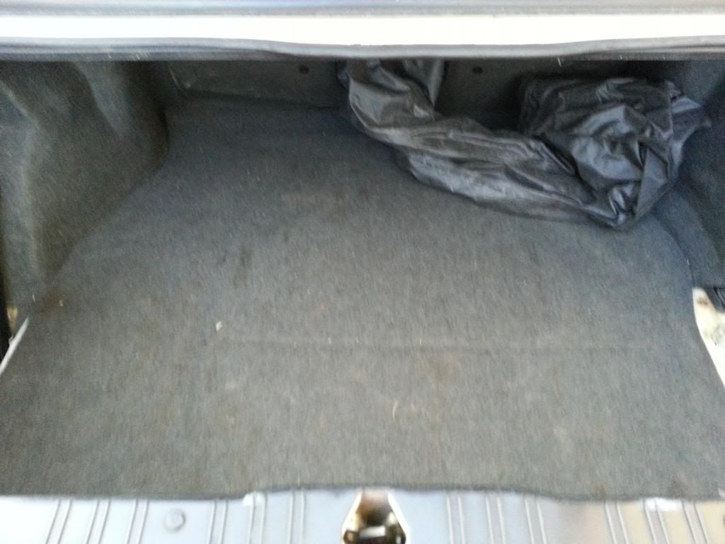

                          I installed a few things
                          Large tool kit holder
                          BMW jack and lug wrench
                          Floor mat
                          What other tools went in the driver side compartment in the trunk?
