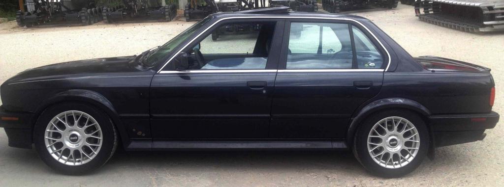

    I don't have height measurements, but here's the H&R suspension back in 2004:
    Build thread
    Bimmerlabs
