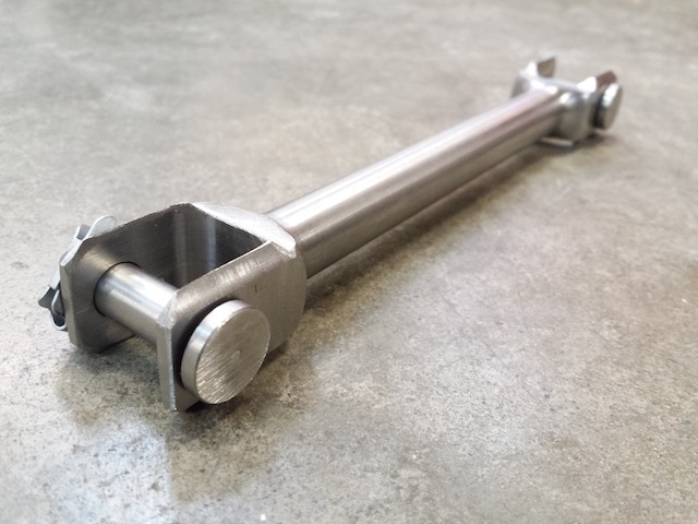

                        The IE is pretty much identical to the UUC. It fits the ix no problem. The dssr did need to be lengthened 3mm though. I told a local shop to extend it an eighth of an inch. Seems to work great. 7.5" center to center seems about right.

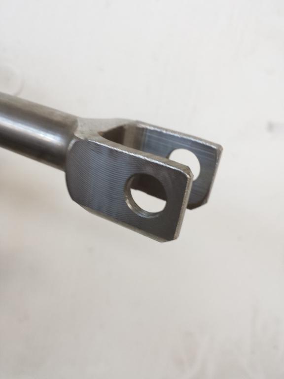

                          I'm still waiting on a few parts before diving into my rebuild, but the e36/189mm DSSR arrived.
                          Check it out. It's machined differently than the one in nando's post #14, and looks like it should cut down on the amount of material I'll need to remove from the rod itself.
                          • nando
                            • 34827
                            yeah looks like just some on the sharp corner there would be enough. the rest is already ground pretty flat!

                              So this turned out really well. Very little grinding/filing needed, doesn't hit anywhere, and feels great from what I can tell. Disclaimer is that I haven't actually driven the car (pulled interior out while I was waiting for parts), but had it all back together, on the ground, and shifted through the gears a bunch.
                              This is all the grinding I had to do:
