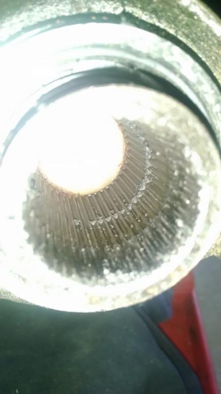

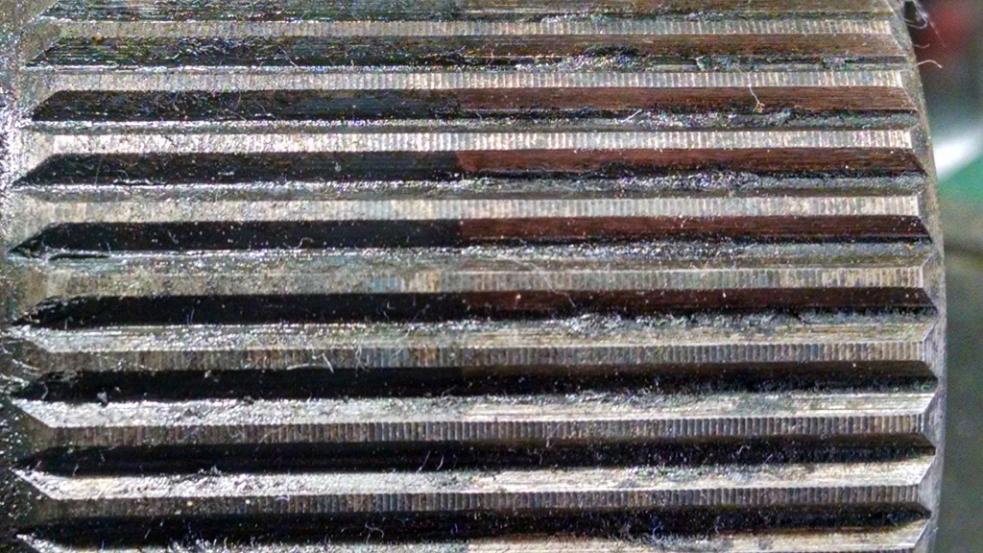

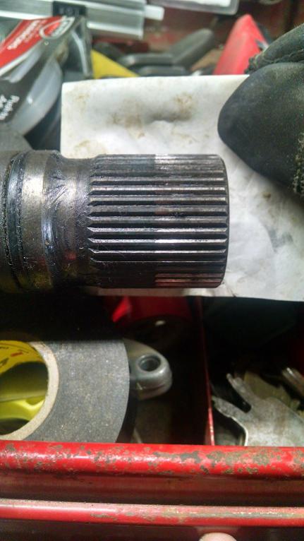

            • TheWipprSnappr
              • Jul 2015
              • 477
              update: I pulled the front driveshaft and the splines for the shaft and output gear looked just fine and had no signs of stripping. With the front shaft out I also drove it up the road and back and the popping noise went away. Could it possibly be due to a worn chain slipping? because with the front shaft removed it wouldn't be carrying a load, thus no slipping correct?

              • nando
                • 34839
                yeah, unfortunately I think you are correct. It's likely if the chain is damaged that it was run for a time with no fluid in the transfercase. The worst part is the chain is basically NLA - you *can* buy a new one, for $900, but that's almost what a new transfercase costs..
                I'd talked to a guy about running two smaller chains which are still available (from a snowmobile) but it would require some machining of the gears. The upside is they are way cheaper than the original chain.
                if there's a silver lining, it drives without the front driveshaft so at least your VC is good..
