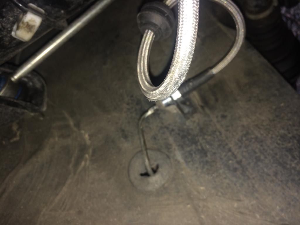

                            So I installed the FCP e36 lines last weekend and there great so far. I wish the front lines weren't so long but it works, on the front lines to the caliper the line but was inbetween a 14mm & 15mm but I just used a adjustable wrench.

                              Brake line rubbing against the wheel all of a sudden today. Buying e30 lines
