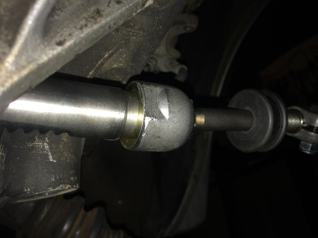

    Actually I have no issues with threading it all the way in, that's the easiest part. I don't have a clue how to bend the locking washers tabs inward.. I did the passenger side with no issues. If you can tell me how to do that then I'll be set. I want to do it right, I don't want to use loctite on the inner end threads or zip ties on the boots. Is there a tool that you used to bend the washers over the tie rod besides a hammer? This is what I can't figure out...

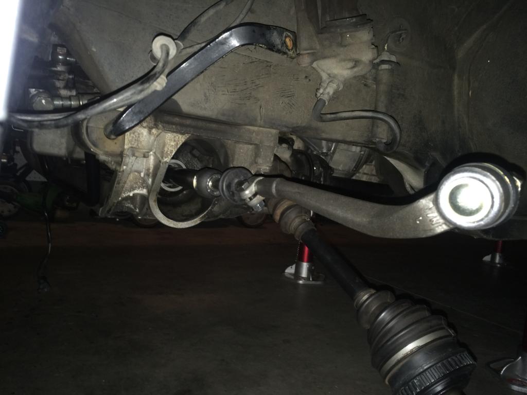

      Also I should mention, I already had to take the control arms out to take to a shop and get new outer ball joints pressed in. Wouldn't I only have to disconnect the ujoint and the two p/s lines that go to the rack? Correct me if I'm wrong but with the engine supported I just have to undo the 4 bolts and lower it. Ofcourse this would be lots more work. Wouldn't I be able to unbolt the rack and then move it left or right or would it be impossible? The joys of a having a iX as a first car. Lots to learn from others experience, hopefully I can bend the washer inward.. Thanks

        I don't remember having an issue with that. I might have used a pair of pliers, or a long screwdriver so I could still hit it with a hammer.

          You're getting there.
          Don't use loctite, that's not necessary. Just make sure its tight. Bentley state about 27 ft/lbs.. i.e. tighten it but don't horse it.
          I had trouble with the washer also - although I took a flat bar and hammered it on the top - bending the tab over just slightly. Bend it towards the inner tie rod. Use a tack hammer or even a steel bar to tap it down.
          In my opinion, I wouldn't worry too much about that tab. just get it bent over as well as you can. I don't believe there's a lot of force on it when complete. The steering rack is threaded into the inner which is threaded to the outer, which is connected to the steering knuckle. I would be more concern that the inner is tight into the steering rack.

            Thanks Nando & 95BMWIC!! You guys are really helpful, when I do the passenger side I use a screwdriver through the subframe, I'll definitely try a few of those methods if that doesn't work. I'm working on a few other things on the car right now so I might not get to it until later in the week.

              Okay so I did this, ended up using some vise grips to mash the washer over the lip. Isn't pretty but it works. Also I tried to use a clamp, took a while to get it on but could get my tool in there so I used a zip tie.
