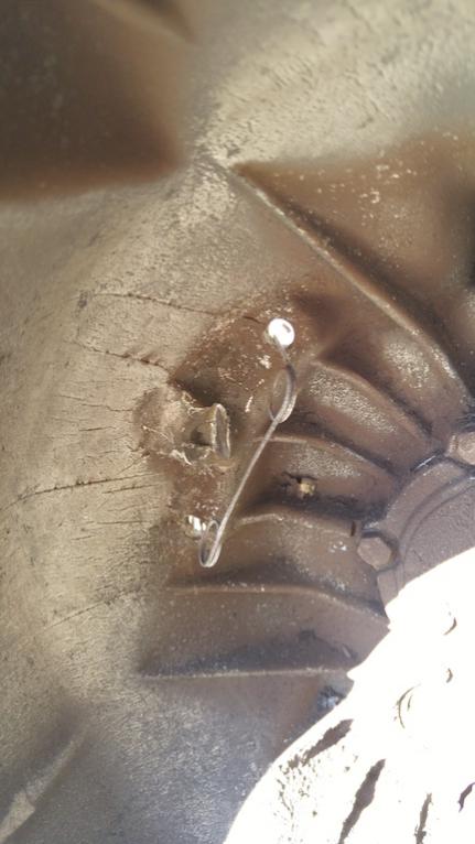

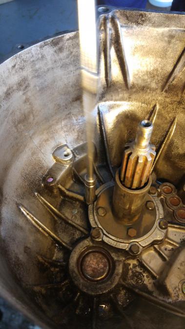

                    Dropped the transmission today and it turns out that ball pin where the clutch release lever sits on wore down or probably was not put back into place properly by the previous owner as the lever rubbed on the housing itself and caused a gash where the ball pin would be.

                        Originally posted by Kershaw
                        Can't you just get a new brass pin? Pictures?
                        Unfortunately, the lever seems to have been rubbing on the housing itself as it made gashes on the housing. See the pics below
                        • Kershaw
                          • 11822
                          Someone more experienced maybe can chime in. I see the gashes but I don't see any cracks or structural damage. Because everything is so dirty I can't really make out any detail, but it looks like the hole is still there. Maybe just clean it up with a dremel or drill?
                          The brass pin inserts into the hole, so I'm not sure what the issue still is. If the hole is mostly smashed, 2 part epoxy/jb weld a new brass pin in place.

                            if the pin mounting boss is badly damaged, check around and see if you have a good welding specialist in your area. They will be able to build that boss back up with an aluminium welding rod.
                            If you feel confident you can do this yourself with the correct rod and a propane torch, it doesn't need a ton of heat to weld that stuff.
                            Once the boss is rebuilt you'll just need to redrill and counterface the boss.

                              I wanted to give you all an update since you've helped out so much. Ended up taking the transmission to a fabrication shop where they rebuilt the ball pin holder for $100.
