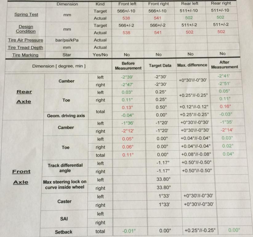

        It is already lowered on H&R's it pretty much looks stock especially with the 14" steelies. I intend on lowering even more but right now the rwd subframe bushing will help correct some of the camber/ toe created by using the longer iX subframe bushings. I also ran into another thread you commented on mentioning the diff needing to be spaced down unless you use a centered bushing. If I get the centered bushing will that correct the drivetrain angle? I don't really want to have a preload on the rear driveshaft flex disc if I can help it. Also what do you mean by rwd washers? You don't need to space the rwd bushings if lowered correct? I kinda want to get the 95a bushings but I'm not really sure how it would benefit my situtation. My current list includes pretty much Revshift rear subframe/ trailing arm bushings and centered diff bushing, and all in 80a.
        Alignment sheet to show camber/ toe in the rear with H&Rs. This was right after the install so nothing was settled and the front has been realligned since.
