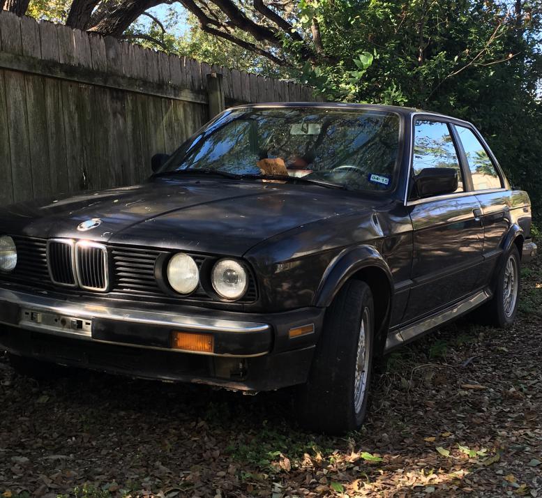

    Hi new member here.
    I bought a 88 325ix a few months ago. Throw out bearing was squeeling and now when the clutch pedal is pressed to put it in gear, it stalls the car immediately.
    Looking at new clutches.. Should I go with something other than oem?
    I might do some future performance upgrades but probably not a turbo.
    Also thinking of putting in a JB aluminum flywheel 8lbs while I'm in there.. Will it effect my drivability on the street in a bad way?
    Thanks in advance
    Jaime
