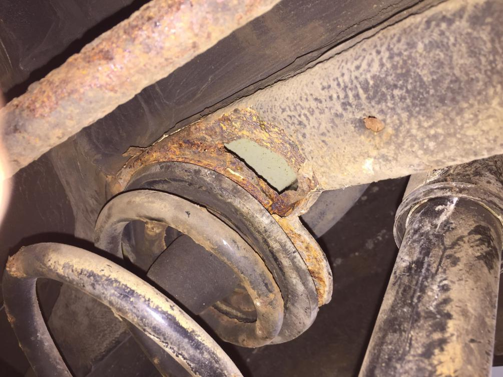

    Hey Guys,
    Still going through the "rust free" 91 ix I bought off this forum from NEO. Seemed like the rust was mostly fender wheels and not structural until I found these holes today on the rear passenger spring perch area.
    Thoughts?
    89 325ix coupe Diamondschwartz

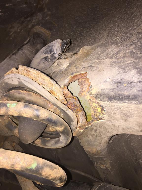

    Rust
    Another pic

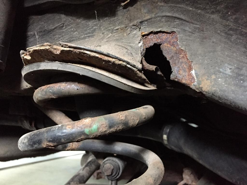

      Rust
      One more....

        I'd say it's fixable. Whether the car is worth fixing as a whole, and whether or not you have the skills to fix it are the bigger questions IMO. But it doesn't look like it spreads too far, and the patch looks like it should be a simple shape to make. If you have to remake the spring plate, that should be simple to make as well. Just a matter of whether or not it's worth doing IMO.

          If you can weld, then it's not hard to cut the perch out of a donor car and splice it in.

            I'm currently doing/getting started to do this repair, it's even a bit worse than yours.
            I suggest removing the plate where the spring sits against as there will be rust between the perch and the chassis rail.

                It's probably fine to drive to the shop as long as you take it easy and aren't hitting any big pot holes. Most of the perches and sides are still there. It is bad, and I wouldn't suggest driving it anywhere else, but you should be okay for a short drive to get it repaired.
                • Kershaw
                  • 11822
                  Definitely fixable. Up to you if it's worth it.
