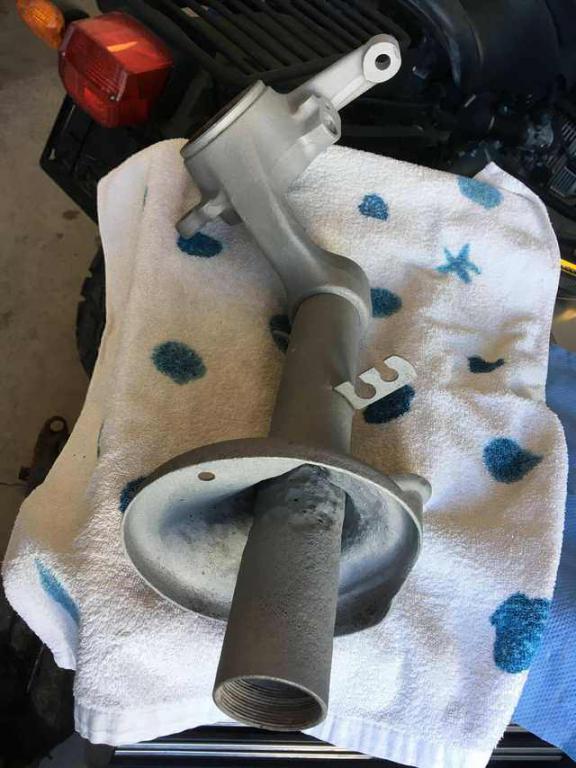

        This is what I had after sand blasting. The threaded part was ok but you can see holes near the lower spring plate so take care. I will search for a one in better condition. https://m.imgur.com/a/W7lHicg

          Thanks for the feedback guys
          Does any one know how thick the upper part is at the threads?
          I'm considering making a new section at work on the lathe, cutting the thinned out section off and welding the new threaded piece onto the existing tube

            2" OD by .120" wall DOM works damn-near perfect (slightly smaller OD than the stock tubing, be aware when welding). The threads are 48mmx1.5mm. I bought a tap for it, but you will be able to thread that easily on a lathe.

              Would you butt weld the new tube onto the existing one or overlap a section?

                Usually butt weld them unless they are getting coil overs. Then you can sleeve it in the same spot the new perch will be. Never had a failure with a good butt weld though.
