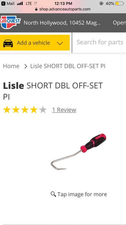

      Yes, drop the rear of the transmission and use an offset pick to get the bit** clip off. Best 10$ i have ever spent.
      This item
      I literally spent no more than 5 minutes to get the clip off.
