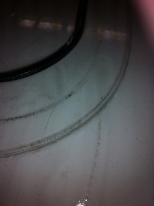

      Top half of the first picture is before bottom is after. Second picture shows deep scratching from a roof spoiler last pic is after is with hand polishing with Meguiars scratch remover.

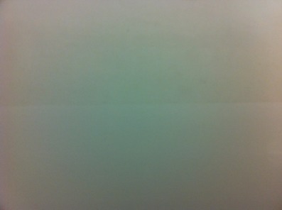

            Polished by hand, then waxed. It's silky smooth and definally breathed some new
            life into the paint.
            I was so impressed I took pic. :)
            The color is grey btw.
