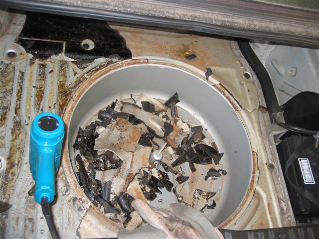

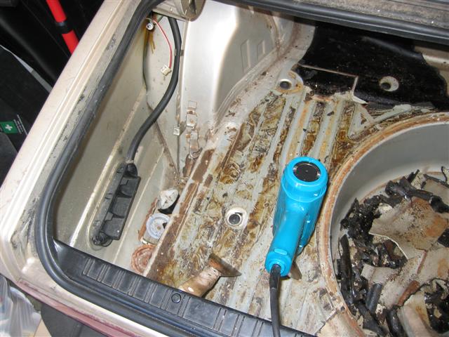

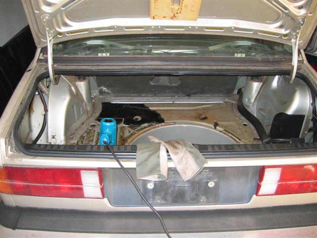

    2nd: Trunk Tar blows, this is a big project. Starting to question why I even started, but saw some surface rust going under the tar and it bothered the hell out of me. It's at least a 12 beer job.
    3rd: Heat Gun sans Gloves equals scars (see pics)
    4th: Starting to realize that taking off the first layer (body color) of tar first eases the job
    5th: This is going to be at least an eight hour job. I'm old and have a bad back, but even with the top of the line makita heat gun on high you have to work in small sections and go slow.
    6th: It's one hell of a mess, and even though I'll do a happy dance when its all off I still have to mineral spirits the residue, prep, prime, and paint the inner trunk.
    7th: I took pics so you can all share in my pain.Click image for larger version

    Do this job in the summer and it all peels up by hand and leaves little to no residue.
    Tenured Automotive Service Professional - Avid BMW Enthusiast
    Vapor Honing & E30 ABS Pump Refurbishment Service
    https://mtechniqueabs.com/
    • Brew
      • 3060
      Sucks for you. Mine came off in like 4 chunks, with no residue left over. No heat gun, just a big pry bar and a hammer.
      '91 318is
      • Jarvis
        • 2132
        Seriously, the removal ritual is extremely different from car to car and depending on when you do it. In one E30, all of it came out in 3 large pieces - lifted straight up off the metal. Another took about 45 minutes with a heavy duty scraper.
        Anyone planning on doing this should wait for a fairly warm day, open the trunk and leave it directly in the sun for a while. That way you'll spend no more than 10 seconds getting rid of all the tar.
          hot summer auto-x parking lot = peeled up easily by hand, with barely any residue...

            hmmm. I might try wacking the scraper with a hammer, sounds like it would leave less residue. As for summer, you know how Oregon is Jordan, anyways I'm halfway done, I can't wait that long, got other projects on the big board.

              mine came out by hand without residue.

                ok, ok I give, just tried hammer + scraper. Not significantly easier. I'll wait for a hot (or at least sunny) day and give it my best. Thank you for the insight. My back thanks you.
