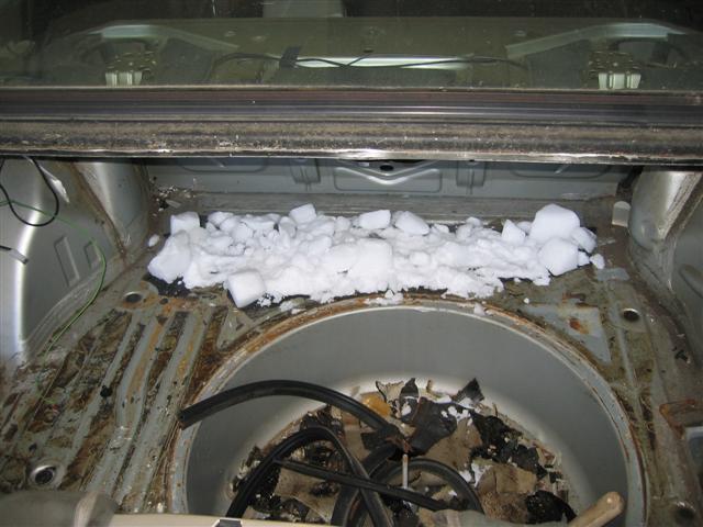

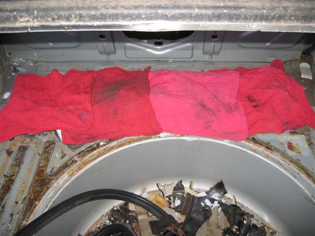

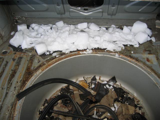

              OK, so about a month ago I did the hot sun routine and it worked like a charm, except the bit under the rear shelf which try as I might couldn't get the sun to heat up. So today I just bought 11 pounds of dry ice @ 1.25$ a pound from baskin robbins. I just broke it up and put on the remaining tar, then covered with rags. My chasis is making all sorts of creaking noises now, hope I dont f*ck anything up. Will report after an hour or so of freezing.Click image for larger version

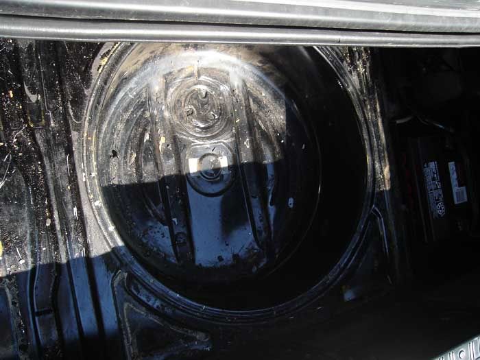

                well that was easy, prolly didnt need that much dry ice, but save for some tough spots, just wacked the tar with a hammer and came off in big pieces. No residue either! I like this method, and reccomend it for anything you cant get off with the hot day in the sun method.
                After pic:
