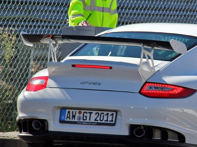

                    The reality is when you say "spoiler" you should be referring to one of these,
                    And when you say "wing" you should be referring to one of these.
