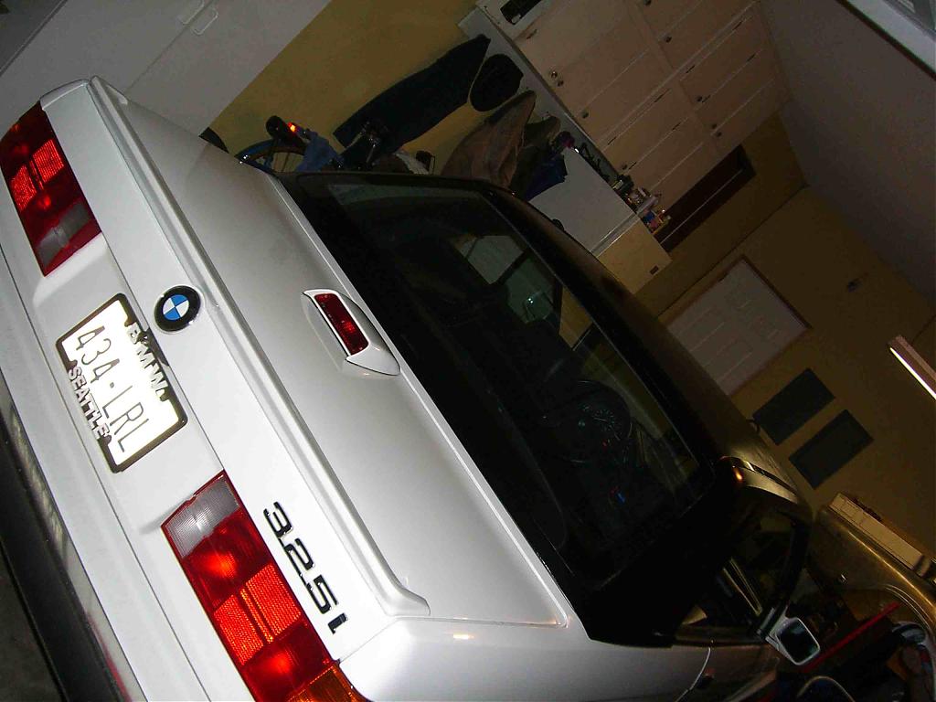

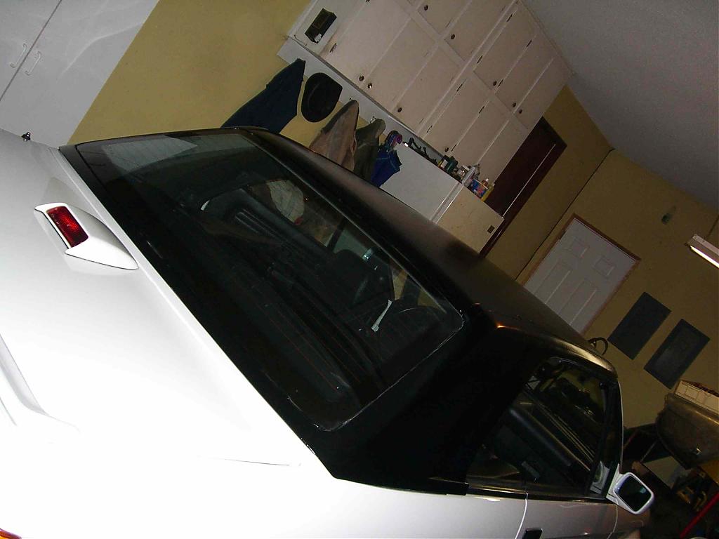

    so i finnaly got it painted and put on. the rear rubber part is not on yet so it looked a little haggard but it seems to have turned out alright. the black paint it alot blacker than the canvas so it looks like a squad car to me

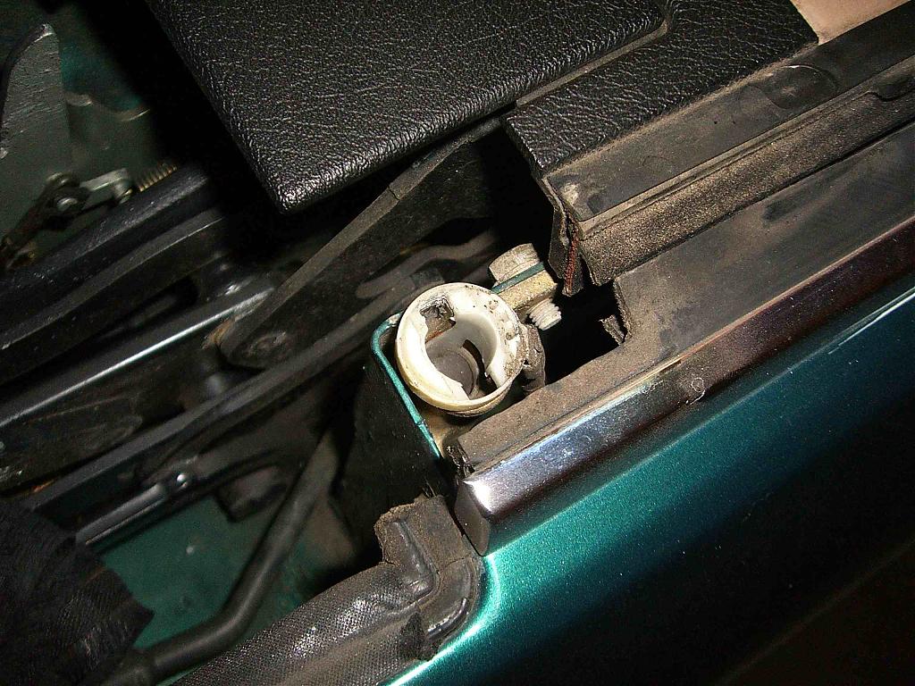

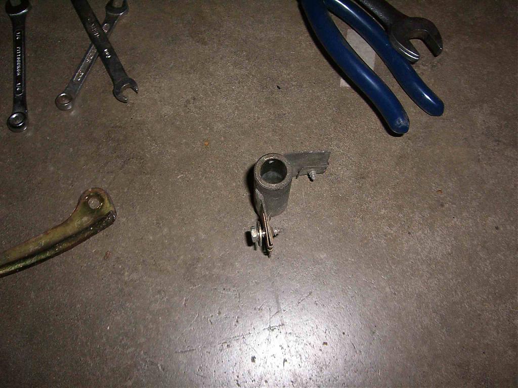

      i also found out that my cabrio wasent set up from the factory to accept a hardtop because the mounting hole/bracket that came on it wasent big enough for the mounting pins on my hardtop. fortunantly my dads (lagoon green 92) had the right mounts so i just quickly swapped them out. the one on the floor it the one that was on my car and the plastic one is the one i ended up using

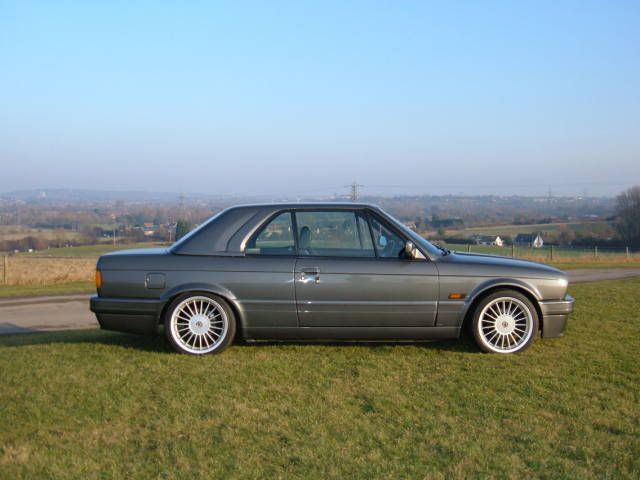

        This is one of my Fav pics with a painted hardtop, Its not mine but props to teh guy that built it. Ill be painting my hardtop to match. Hopefully it turns out this well
        This one too.

            i thought about painting mine body colored to but that would have costed too much money to do it right. they look really good though
