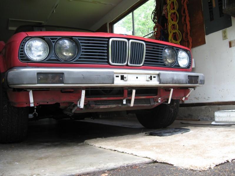

          I used 1/8" by 3/4" aluminum stock available at most hardware stores. Used a couple of bolts in the bench for a bending jig and some pop rivets. It's not going anywhere.

            +1. I used a vice & the same material, came out great. Aluminum is brittle so make sure you get your bends right the first time.

              I remember seeing your thread with that a while back. I thought about doing that but I don't have anything to reference the size or how to attach them :| fabrication isn't one of my strengths haha
                          What lip is that on the bottom of the valence? Custom? Looks nice. Any more pics of your car?
