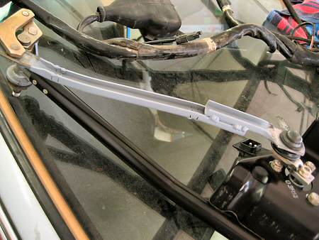

    It does look like the left side in that picture is shorter than the one I just pulled out of a car.
    Ummm... thats upside down, but I'm not sure if LEFT side in picture is shorter.
    Same effect is achieved by adding lenght to lever that is by the motor.

      my rendition. it removes the need for the drivers side linkage. only catch is you might need to hammer the firewall in a tad to keep from excessive rubbing due to the new angle of the middle wiper linkage.

        That plastic cover is easy to make, no need to buy one. Cool idea on removing the driver side linkage.

                      I can't imagine it being that hard to make this work. Even moving the motor to the middle. As long as you know the sweep of the motor.

                        can someone post a picture of the bonrath linkage and the stock linkage sitting next to each other?
                        the more detail the better.....please....
                          do what Rocla said and it works.
                            the motor doesnt have a "sweep" it only rotates so you really cant move it to the middle. the setup requires the small arm to make the reciprocating motion for the wiper.

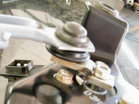

                              Did you not look at the link i posted? The wiper motor just turns, it's the arms that loop to make it seem like it turns back and forth.
                                Rocla,
                                I modified the linkage like you said today! I actually took about 13-14MM out of the linkage, it might have been too much! I put the linkage into my vice and turned it by hand and it certainly had a full sweep! THank you for posting that information! Free mods rule -- especially when they cost $200+! And I was gonna pay that!!
