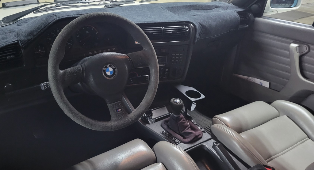

                    The e30 one has straight across spokes . E36 dips down on the sides . Also in the back hub it has those notches for the steering wheel lock . E36 doesn’t
                    • arcpolo
                      • Aug 2019
                      • 134
                      Here is a 370mm M tech 2 wheel from a e30 M3 evo.
