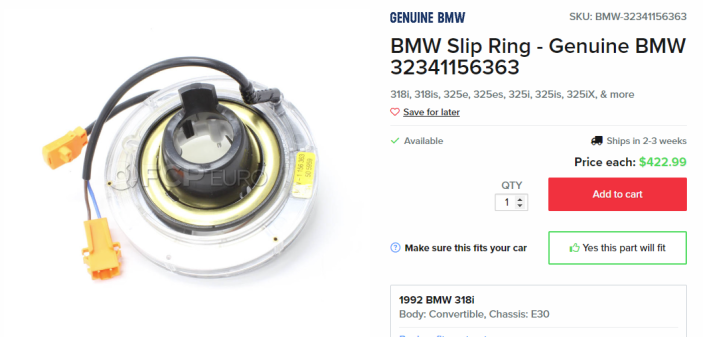

          Is this what's missing? Part # 32331152896
          Looks available for $20ish
          That part # does not cross reference with the airbag wheel which uses slip ring: 32341156363
          Although it does look like the non-airbag slipring might be the same part as the airbag one, just with an extra base for the airbag:
          NON-AIRBAG
          Click image for larger version  Name:	slip-no airbag.png Views:	0 Size:	90.7 KB ID:	10096145
          AIRBAG:

            Confirmed from all... the new wheel needs the non-airbag slip ring and two bolts... Ordered from Pelican Parts that had it in stock.

              It’s been so long since I’ve seen an OG airbag wheel’s horn contact ring I didn’t remember if it was the same or not. Glad you got it sorted
