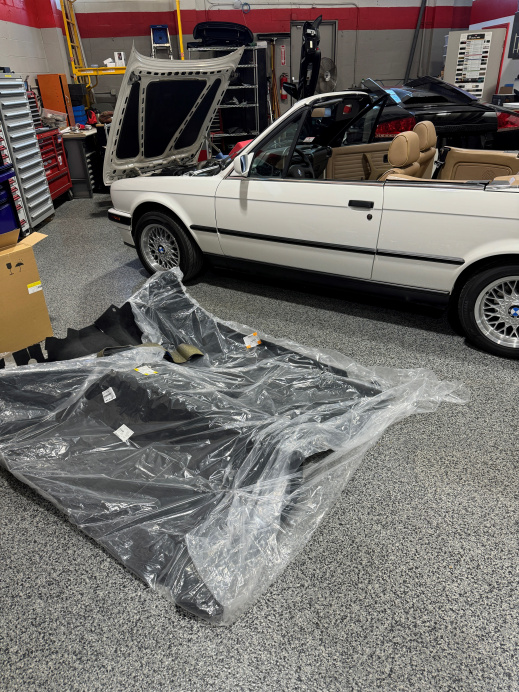

          I was able to order a new one from getbmwparts.com for my 92 e30 vert.
          https://www.realoem.com/bmw/enUS/sho...41#51471942689
            Awesome! Thought it was NLA. Quality seem comparable to the original?
                  It appears to be identical to original. The color perfectly matches e46 black floormats as well. Having them fit now.
