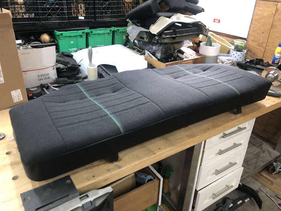

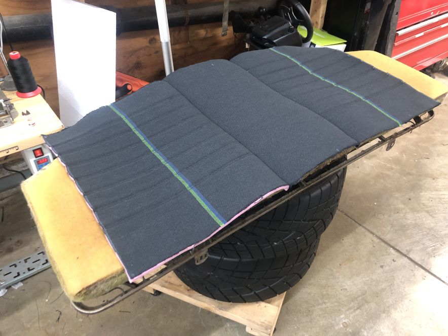

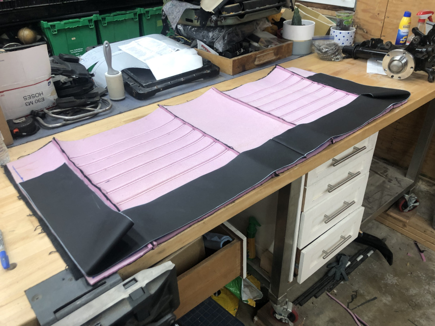

                  I’m currently DIYing an Alpina repro interior, making the rear covers from scratch. It’s not quick work, but I am having fun.
                    Woah, that looks fantastic! Any tips if I go a similar route as you?

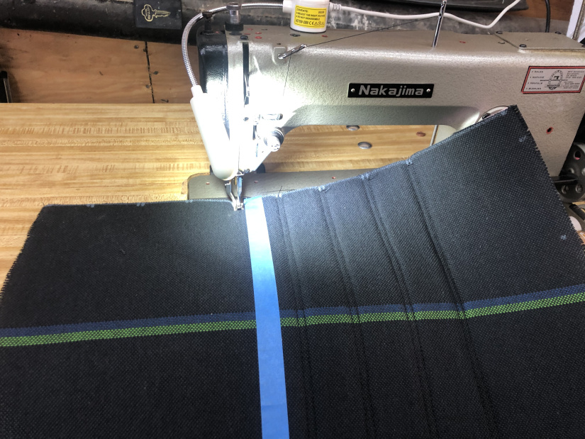

                    • kronus
                      • Apr 2008
                      • 13032
                      There is a YouTube channel called Cechaflo where an upholsterer posts many upholstery tutorials. They’re not quite step by step, but after watching a lot of them I had a good idea of what tools are needed, what steps are done, and what it looks like to sew seat covers properly.
                      The rear cover is also a good place to start since it’s mostly just rectangles. Front seats have all sorts of curves, and curves are harder.
                      To get used to the sewing machine, I first did a bunch of shift boots and a couple steering wheel recovers. Also a walking foot machine is necessary, they can be quite expensive. I found an obscure one on eBay for $450 and had a local tech go through it. Commercial grade ones can go from 700 for a used Consew to thousands for a shiny new Juki. But, all you really need is walking foot, and reverse is useful too.
