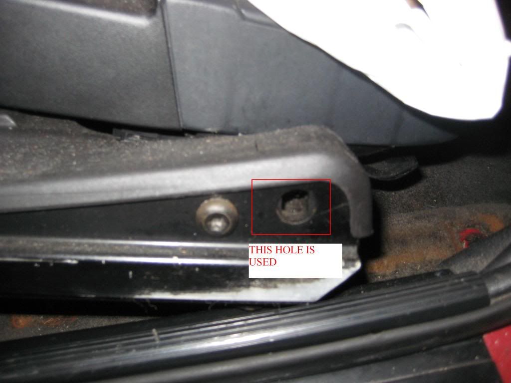

                The reason why I think e30 coupe seats fit in a sedan, is because the coupe seats also have the bracket to bolt the bottom of the belt in. As stated above, the e30 coupe belt goes from the B pillar to the bar on the floor, while the sedan goes from the B pillar to the actual seat rail where there is a bracket to bolt it to.
                I am going to have to check my Vaders but I doubt they have that. What I think I am just going to do is weld a 1.5"x1.5" steel plate to the rail with a hole in it and run a nut and bolt through that.
                This is the side of the Vader. It has those two holes on the side, I need to check mine tomorow and see what they are. If not welding may be the only option.

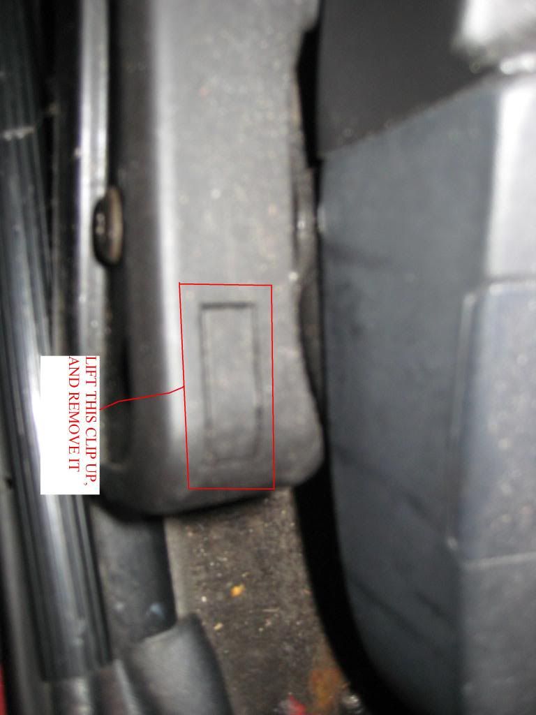

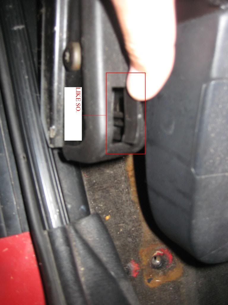

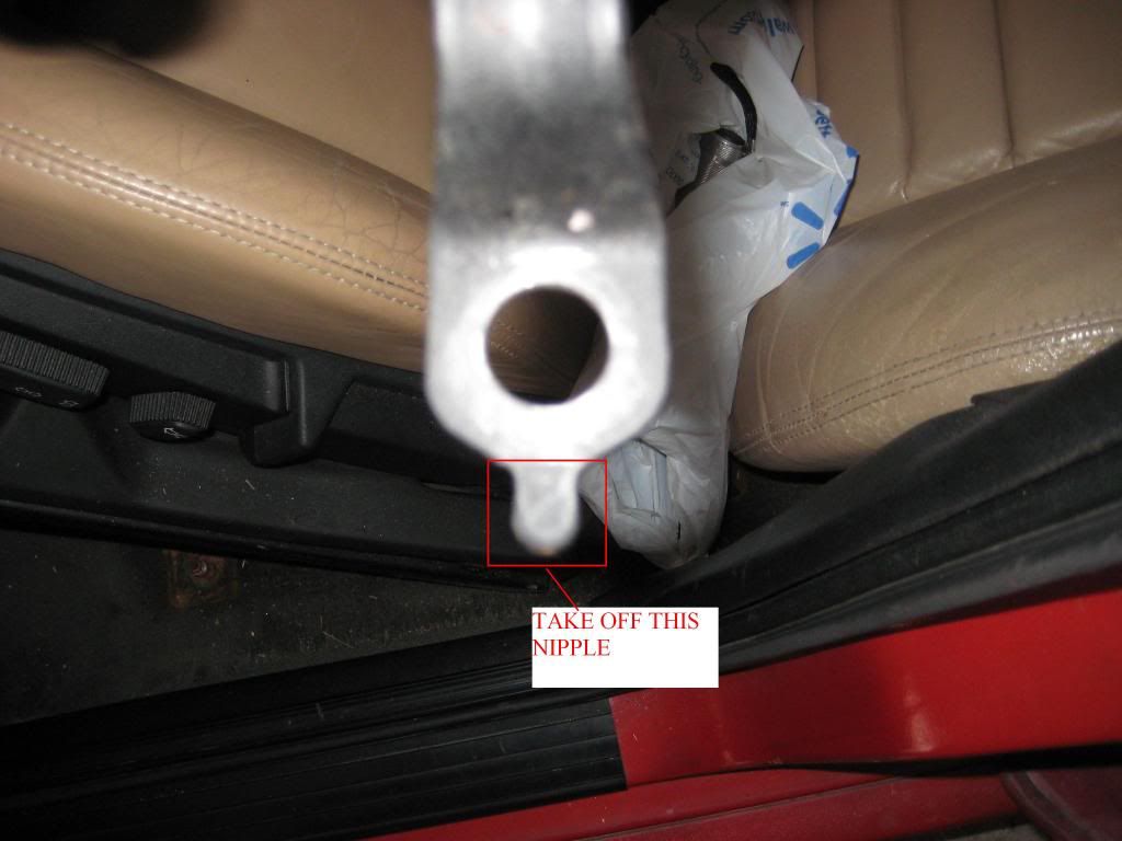

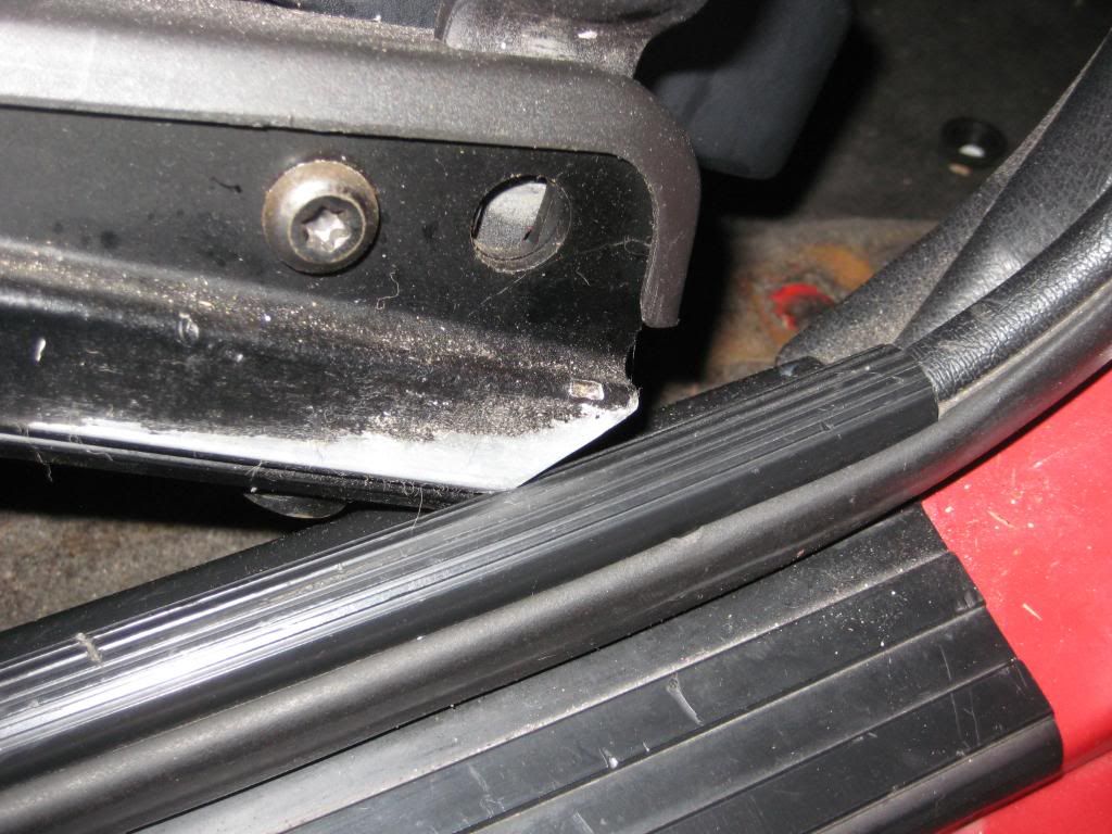

                    The mounts are not what worries us, it is the seatbelt bolting up.
                    After looking at my vaders today it seems that one of those two holes in the Vade pic I posted above will work. You have to bolt it through the hole. I will take pics of mine today.
                    I would like to see how the seatbelt works on an e36 sedan. I am betting it is the same way as an e30 sedan.
                    • motorsports_3
                      • Mar 2007
                      • 1058
                      Okay, so I figured it out. Of course I am not responsible for any of this infomation.
                      When you put it in without modifing the nipple, it doesnt go fully in. I am not sure yet, if with the nipple shaved off if it will still fit. You may also have to lengthen the hole. When I install mine, I will edit this.
