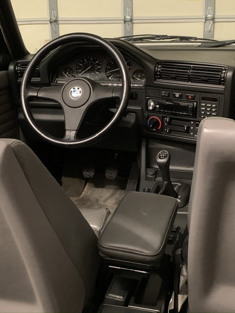

                          All of the above is correct. I put a 3-spoke in my 1992 cabrio. Now I don’t hate my steering wheel.
                          I kept my airbag steering column turn-signal and wiper stalks. They’re close to the back of the steering wheel, but I don’t mind driving it like that.
                          Word of advice: make sure that the airbag system is completely de-energized and discharged before messing with the airbag steering wheel. Those things can kill if they go off inadvertently.
ID:	9926700 Click image for larger version
