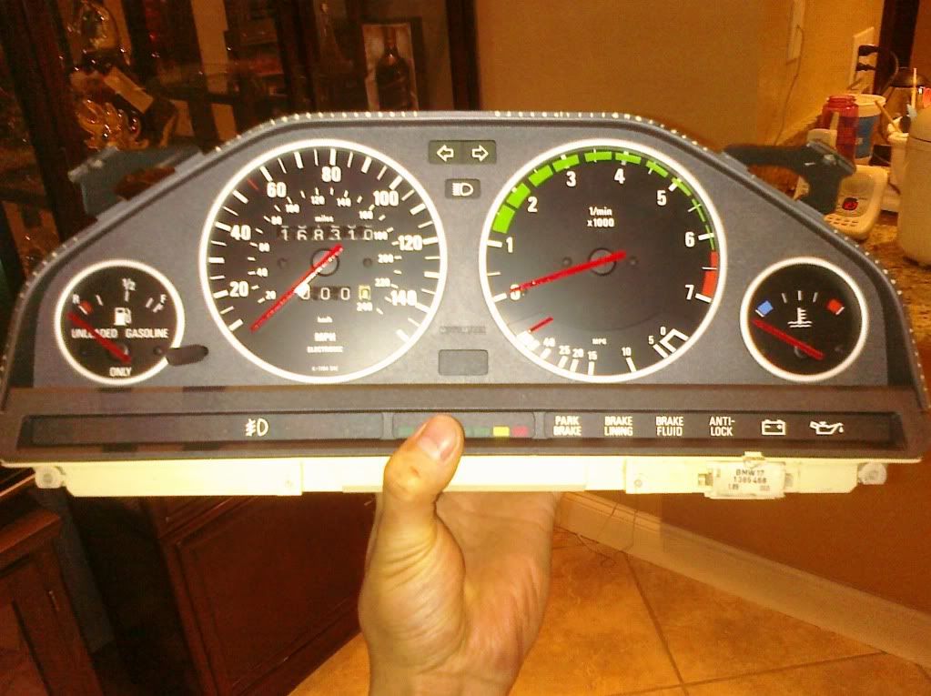

              #66
              Shitty cell pic, but here it is finished. I still need to bolt everything down, this was just a test fitting to make sure all the damn gauges actually worked this time. I used the same red on the needles as I used before. It's almost orange, and matches the color of the redline area perfectly.

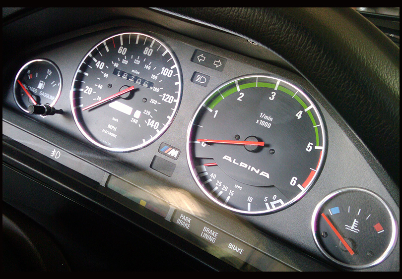

                #67
                FINALLY finished. Everything is back together, everything works. I hope to never have to pull this thing out again.

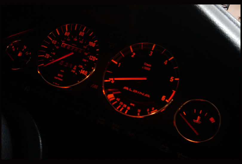

                          #72
                          Originally posted by dude8383
                          Dude, that came out badass. Can we get a shot of the cluster lit up at night?
                          Sure. Not the greatest picture, but it looks pretty good.

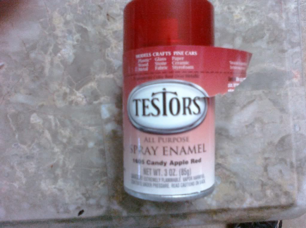

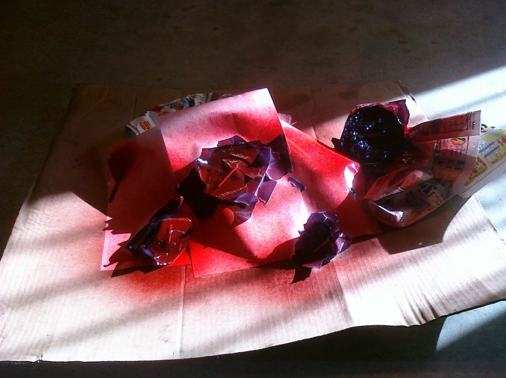

                              #74

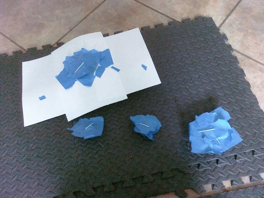

                              Just did my cluster. Don't use the Testors Candy Red. Don't know if its because it is supposed to be transparent or because it is usually sprayed over silver but it does not come out smooth. The first coat was fine but when I did the second coat it did not want to self level. I might have gotten a bad can but the nozzle looked fine. Next time I will get their bright red, I don't really care though cause I screwed up the tach strip too. Might redo everything sometime before summer. I tried taking everything out but I couldn't get the speedo so I just covered the cluster with paper and taped everything else off. The MPG econometer was sprayed too, I moved the needle to the middle where it will expose as much of the needle as will be seen and held it there with tape then I just sprayed everything.
                              Did not like this, go with their non transparent paint.
                              Taped off
                              Sprayed
                              Done, tach stripe looks horrible but no one else will notice. Next time I will spend more than 45 seconds on it. It is not as textured or bright when installed and behind the glass cover.

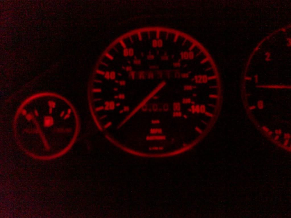

                              When lit up it looks like just before.
                              Maybe I will take a better picture tomorrow but when installed a lot of the defects are not as noticable.
