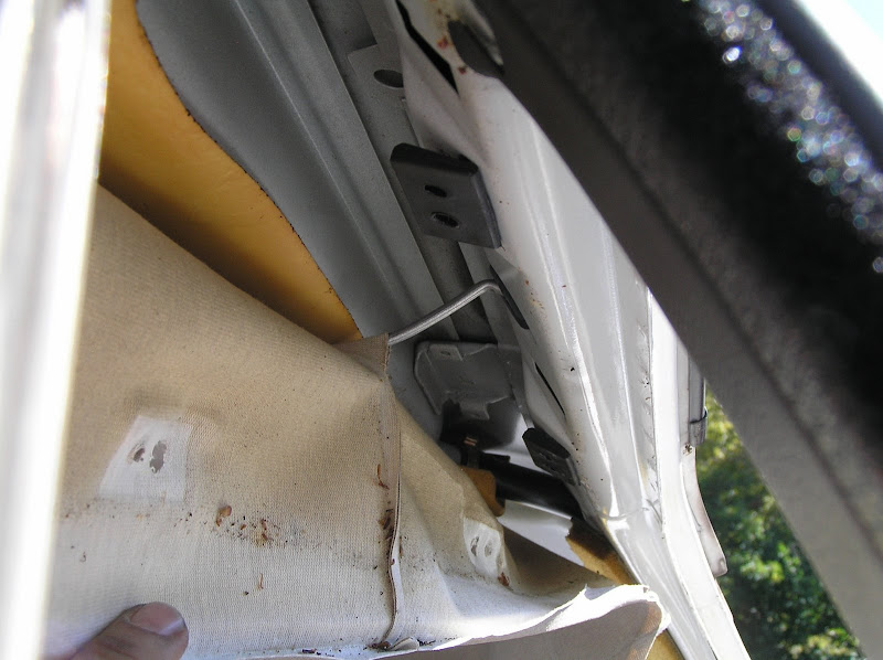

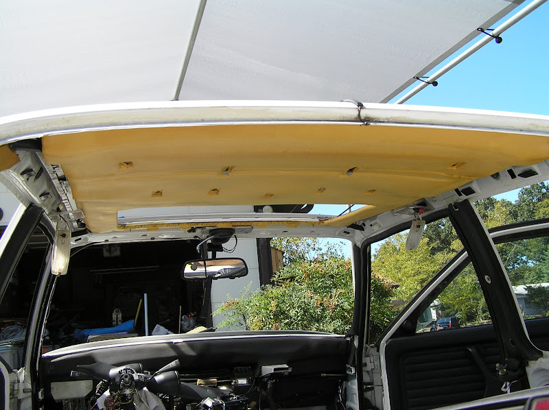

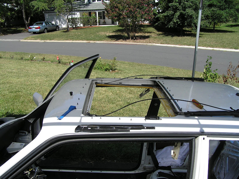

            There are two rods that hold up the headliner over the back seat area - the rest of it is held up by glue. If it is a two door, you'll have to pull the rear side windows out. If it has a sunroof, it has to be glued there, as well, although there is a metal bar that will hold it in place. It has to be glued at the rear window, the c-pillars, over the doors, at the sunroof, and at the front window.
            It's not a fun job, and getting it to fit properly without sags is a PITA.
            I used 3M Super Trim Adhesive.
            Oddly enough, no pictures of the finished job. :( I'll rectify that when I can.

                            You're going to drive your car to them with no glass in it? And the sunroof in pieces?
                            To put in the new headliner you need to remove and reinstall everything anyway - actually taking out the old headliner is such a small part of the job that I doubt you would see any difference in cost, and I would probably charge you more just for the hassle of having to figure out the puzzle of how the parts all go back together without seeing them come out.
