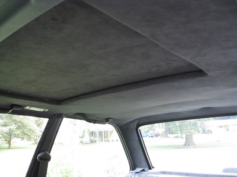

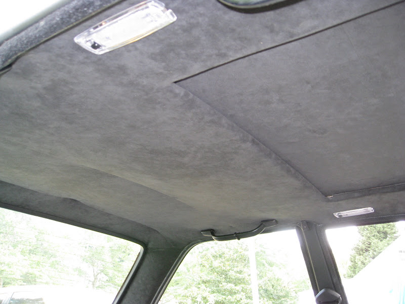

            As promised, oh-so-long-ago, completed pics. Still not 100% happy with it, but it looks pretty good and I am overall pleased. The sunroof liner fit is very tight - it took me a lot of swearing and multiple attempts to get the liner reattached to the rear of the sunroof lid. The material is not too thick, but definitely much thicker than the OE material. I think it needs some time to wear in, but it makes the sunroof noticeably stiffer to open.
            Make sure before you seal it up around the rear windows that you ensure that your Jesus handle mounts are in place - I had to do some fishing through the finished headliner to position one of the mounts back in place. They have two locating tabs that hold them in place, and one of mine was broken - which I should have noticed; I think I actually did notice it, but then I forgot to fix it before gluing everything up and reinstalling the rear windows. Once you get it all apart you'll see what I am talking about. And this is an excellent opportunity to replace the domelight mounts, which I was going to do, but mine were uncracked so I left them alone.
            Also, watch the corners where it wraps up around the sunroof hole - it's easy to cut them too short and wind up with exposed edges.
            Pics:
