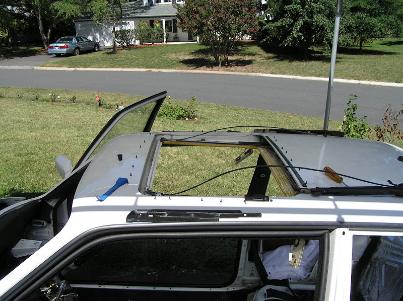

its like the very bottom piece in the sunroof assembly it sits right on top of the headliner which is glued down to the foam underneath these pieces. i think they are the main tracks.
if the windshield has to come out whats the point of the sunvisor panel?Your signature picture has been removed since it contained the Photobucket "upgrade your account" image.
Originally posted by TimKninjaIm more afraid of this thread turning into one of those classic R3v moments, where Pizza gets delivered.Comment
nah its on each side of the sunroof, under your cables in that picture, they have the channel the cable sits in
this is the best shot i can find of it from japandrews thread,
Last edited by NC325iC; 07-22-2009, 07:00 PM.Your signature picture has been removed since it contained the Photobucket "upgrade your account" image.
Ahh, that - IIRC, that does come out when you remove the long trim piece on the back there. It has some sort of putty holding it in place, but I am pretty sure that came out. Just make sure you remove it carefully and don't bend it.John in MD - 1991 318is
