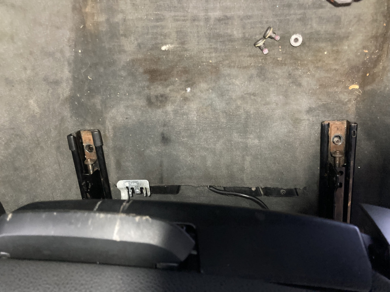

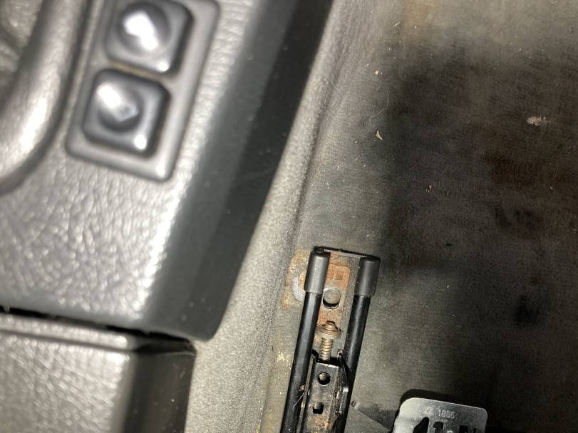

      Sorry to revive an old thread but my front bolts just wont line up in the front, warped floorboards or do I need to whack it in more?

          So how does the seat line up when the front two holes are sort of bolted in like that? Like centerline of the seat to the wheel, arm room, etc?
          Looks like all the seat kits including the Lown version shift the seats outboard so I'm wondering if that's because they're off-centre when installing into an e30.
