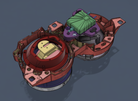

            I recently completed a bi-xenon conversion in my DEPO Smiley's and have a few friends asking about a conversion kit for the US Ellipsoids. I'm picking one up this weekend to start working on the design process. I can keep you in loop if this is something you're still interested in.

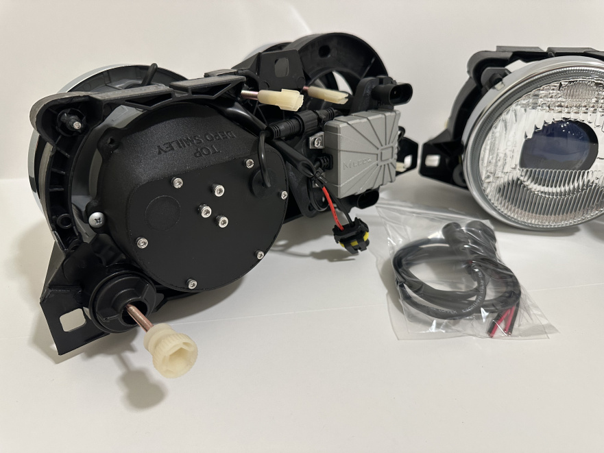

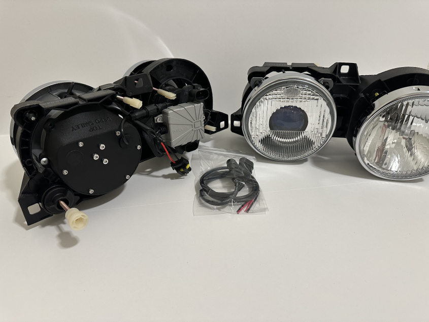

                  I have a kit developed for the Euro Hella's & DEPO headlights along with US Ellipsoid & Bosch Smiley. The OE projector is removed and new adapter with the Morimoto projector is installed in the stock housing using the factory mounting points. I sell a full kit as a turn key solution shipped to your door utilizing the DEPO Euro glass style headlights. Plug and play connectors for 9005/9006 & H4 cars means no extra wiring needed. My adapter reuses the headlight seal to ensure a weather tight seal between the headlight bucket and MLED projector adapter. Printed out of a PA12 nylon making them super rigid with a high tensile strength & low moisture absorption. 5052 aluminum backer mounting plate acts as a heatsink to disperse heat and provide rigid mounting for the projector.
                  I currently also support a full HID kit for the Euro Hella/DEPO, US Ellipsoid, and Bosch Smiley. The MLED will fit in all E30 headlights except for the sealed Sylvania H4’s and Bosch Smileys at this point.
                  I also offer the 'DIY' kit solution if you want to retrofit your current headlights. My website is working but still majorly under construction.
