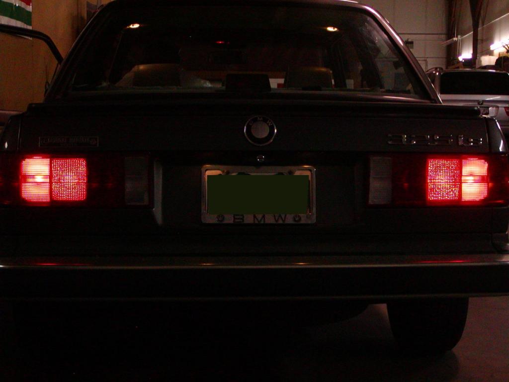

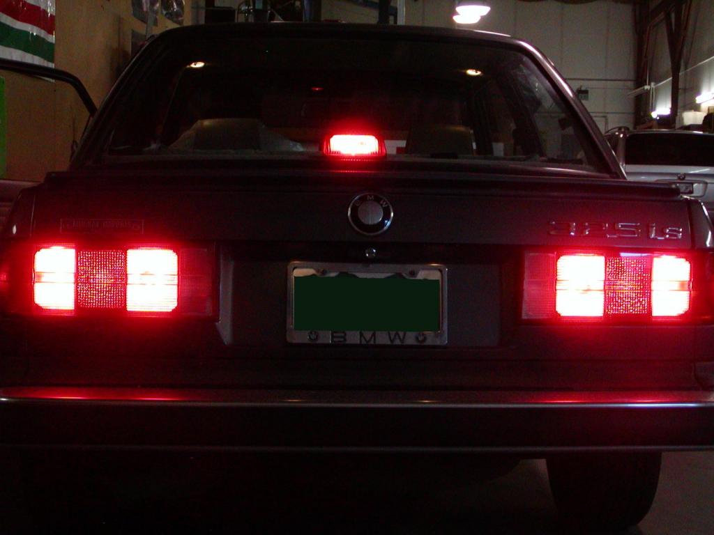

                Converting another set of early style lights from a 1990 325ic 'vert (c for Convertible or Cabriolet), including upgrades to dual tail light, dual brake light, and high output bulbs everywhere. YES, it makes a huge difference, and NO, the two tail lights are not exactly the same. If you look at the pictures (taken from about 6 feet away) you will see a difference. If you are in a car or truck 60 or more feet away, you might not notice this, but WILL notice the car's larger and brighter lights, especially the brake lights. Isn't this the desired result?
                Also have found some high output bulbs for the center brake light on the trunk lid, 21 candlepower versus the wimpy stock lamp. I advised Steve to remove and clean the center brake light inside and out, for maximum output... perhaps he's report his impression of the outcome?
                Stay sharp out there!
