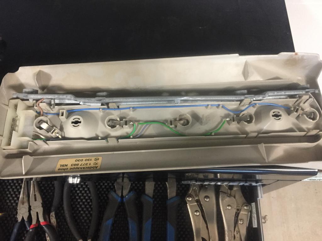

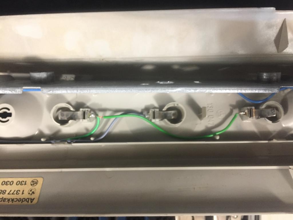

                              Bumping an old thread at the request of 2mAn.
                              See the attached picture showing how I wired my rear fog lights as additional brake lights.
                              Wire and terminal were sourced from a spare bulb holder.
                              Note that I am using LED brake light bulbs, which reduces current draw.
                              Using all traditional bulbs would double the load on factory wiring with this modification, so attempt at your own risk.
                                See the attached picture showing how I wired my rear fog lights as additional brake lights. Wire and terminal were sourced from a spare bulb holder.
                                Best way to do it - use factory parts to take advantage of the idiotic DOT regulation that forbids a rear fog light.
                                Too bad we can't get the terminals in bulk from Startec! Every busted-up E30 light I come across in any parts yard gets a terminal-ectomy, which I then put to good use in another E30's tails. each pair of broken back covers will allow 4 other cars to get this upgrade. 99% of the time folks need the lens anyway, so when the lens is busted, the back side goes begging.
                                Note that I am using LED brake light bulbs, which reduces current draw. Using all traditional bulbs would double the load on factory wiring with this modification, so attempt at your own risk.
                                Bravo, and again this is the right way to do it, as long as the results are highly visible - If I might ask, which LED Light bulbs are you employing?
