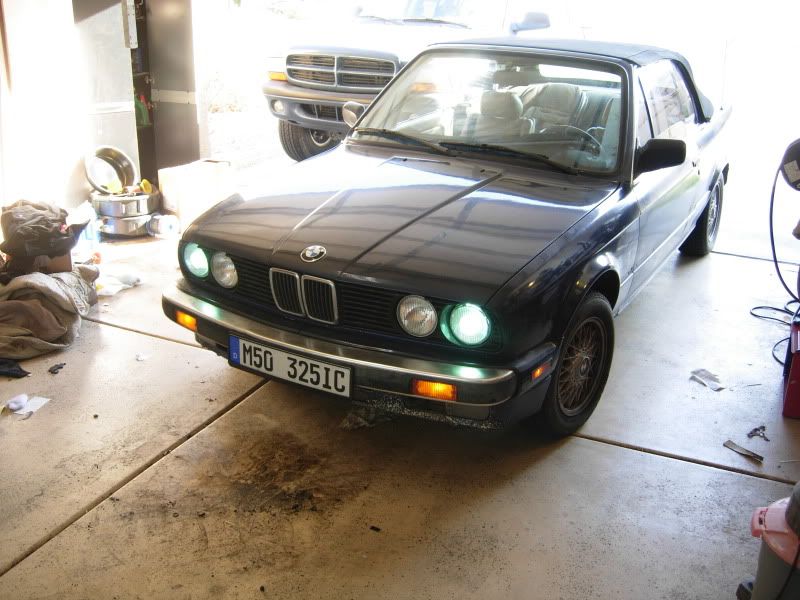

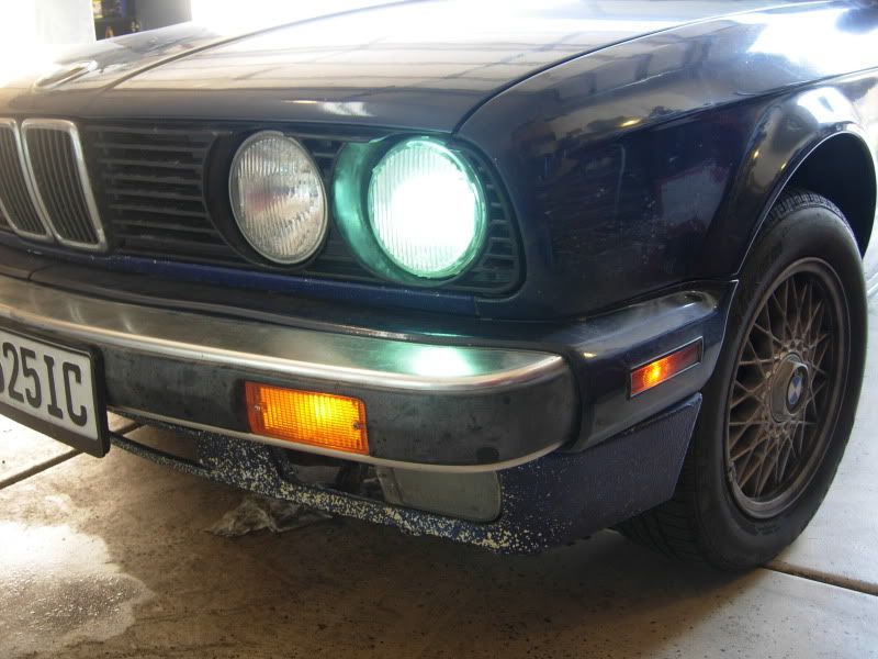

    They look blueish when you look at the bulb but the light it throws on the road is white.
    From the thread you started about DDM carrying only 3 colors I guess these would actually be 4700k.
    I'll update pictures once the sun goes down to show color and cutoff beam. Only have the cell camera so it wont be 100% true to life.

      I find most people don't have a very good eye for spotting colors.
      It will be really hard to tell at night what color it is in a picture. The camera will auto-white balance to the headlights making it appear white. You'll want to take it on a sunny day from a distance way for best comparison. Sun light is always the same color, and you're camera will adjust to that rather than the headlights, thus showing the true color of the headlights.

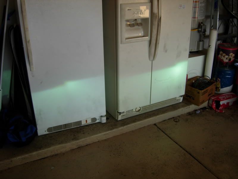

          #184
          US ellips cutoff. The light is similar in color to my high-beams, just focused on the road.

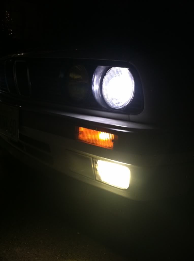

                #187
                5000k 55 watt low beam
                us ellipsoid with smiley retrofit
                3000k 35 watt fogs
                stock fogs

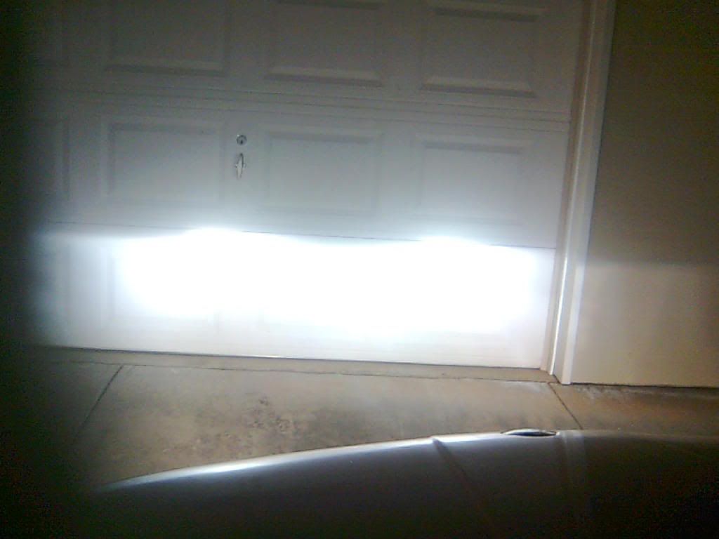

                    here is my setup:
                    Us Ellipsoids
                    Xentec Ballasts
                    Xentec 5000K (allegedly) bulbs
                    Seems a bit blue to me, more like what 6000K+ would be. Really does show blue at night.
                    Due to this, I have some 4300K Morimoto bulbs in route.
                    I am getting a nice sharp cutoff, similar to what I had with halogens. Proper adjustment has me getting decent range at night as well.

                      #190
                      Originally posted by scottinAZ
                      here is my setup:
                      Us Ellipsoids
                      Xentec Ballasts
                      Good man! The 4300K bulbs are pretty legit, although coming from ~6000K ones you'll feel like they are a little yellow at first (they aren't).
                      Maybe the white balance is off in your camera. If not, those look like 7000K ricer-special bulbs!

                        ^^ looks like your passenger side beam is brighter than your drivers side. i have us ellips aswell and it looks like mine is brighter too. or am i just trippin?

                          #192
                          I set the white balance to "daylight" they are fuckin BLUE...
                          I dont mind the yellow, hell the halogens were, I just want more light output.
                          Might be, could also be just the angle of the camera, I dont notice a difference at night. I also just replaced pass side low beam housing, so its probably a bit cleaner as well

                            #193
                            You will be much happier with the Morimoto bulbs. The light output is good, and people won't confuse you for a Civic. They have that OEM blue/violet look when you look at the car from 20ft away at night, and the light they they put onto the road is nice & white (you really will feel like it is yellow after having your current bulbs, but it is much whiter than the light from Halogens).
                            The difference in brightness could be two things. One, if these are cheap re-based Xenon bulbs, they are probably cheaply assembled & the arc chamber position differs between them. Two, the reflector dishes in your light housings might be unevenly oxidized from decades of use, with one being less reflective than the other.

                              #194
                              third option, the bulb is not tight in the housing. I tightened the tabs on the pass side, so the bulb does not move around at all. there is some slight wiggle in the drivers side, so the bulb is not accurately positioned. Ill be fixing that when I install the morimotos.
