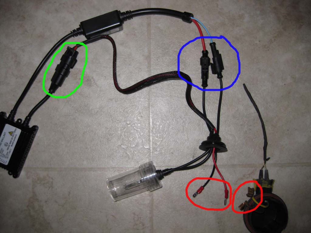

      Alrighty ... I am gonna pass this by you experts just to make sure that I am doing this right (pretty sure I got it down, but you never know).
      So, the bulb has three connectors coming out of it, one is in green and the other pair in blue. If I understand this right, the connectors in blue are supplying power to the bulb via the ballast. Now on the other end of the connector in green, is pair of wires in red. These would be soldered to the wires in the weatherproof housing (also circled in red), thus supplying power to the Ballast once the plug of the housing is connected to power and ground, which I would do by cutting the sealed beam plug and running ground and one of the power wires to it.
      I was thinking about connecting the city light while I was in there to, so I read up on a couple of threads and come people were using the extra power from the original sealed beam wiring and running that to the city light, along with ground (via tapping into the ground going to the low beam). I'd like it to come on with the parking lights, so I might just tap into the wiring for the side markers and run em that way, not sure yet.
      did I miss anything?? suggestions??

        Yes, that's it. I understand why but I don't like the fact they route the power wires inside where the bulb area. I guess they all come like this and it works for most configurations but I cut and removed those wires from the grommet. This bypasses the need for the lowbeam connector and there's no risk of a short from having the + / - connections crammed under the cap. It's upto you.
          i here ya ... thats the part that made me so confused on how the hell to wire these. I think I am going to go ahead as I described and see if it fits, if not ... then the solution is as simple as you said.
