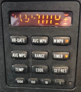

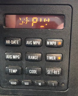

    Hey there folks, I just got done replacing the screen on my OBC, and now it's all screwed up. It works, I can select between range, time, etc, but it's impossible to read. The screen just displays a garbled mess of characters. Anyone had this issue, and if so, how did you fix it?
    Pics for reference.

    It looks like you got an incorrectly assembled screen unit. The large digits belong on the left, and the smaller ones on the right. Or, if it is a super-DIY screen replacement, then I guess you rotated it 180 degrees and just need to rotate it into the correct orientation.

      yeah, I agree - you put it in upside down.
