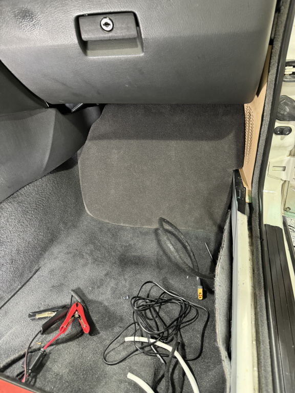

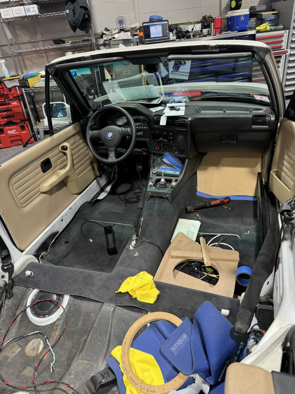

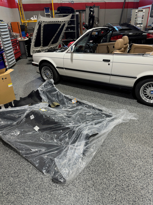

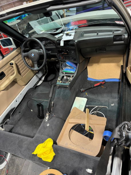

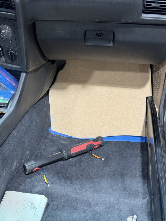

    Starting in order that things were done... First, removed the seats and the old tan carpet--we had to cut it to get it out. New black carpet installed. The new carpet matches the newer BMW floor mats. I'm going with e46 convertible floormats. You have to trim the driver's one to get it to fit--I had a local home carpet store bind the cut edges for me.

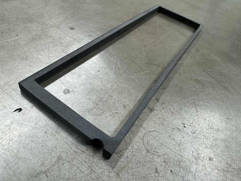

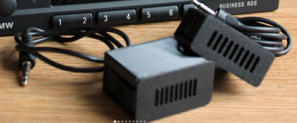

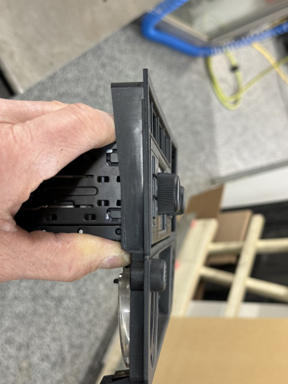

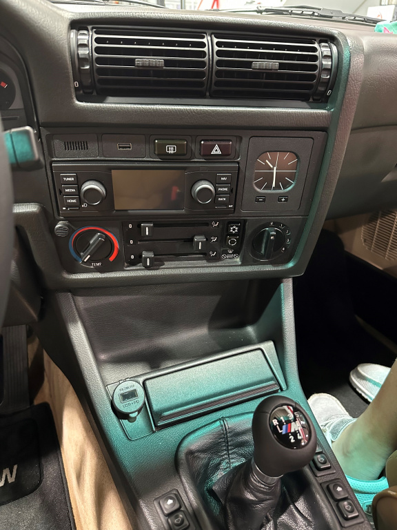

      Test fitting the Porsche Classic Headunit. The microphone will go into an empty slot above the radio. @bmwradios custom makes them. I'm going to remove the USB port. Didn't love it here.
      Click image for larger version  Name:	pc2.jpg Views:	0 Size:	193.3 KB ID:	10113613
      Click image for larger version  Name:	pc1.jpg Views:	0 Size:	204.3 KB ID:	10113614
      Click image for larger version  Name:	mics.png Views:	0 Size:	134.1 KB ID:	10113615

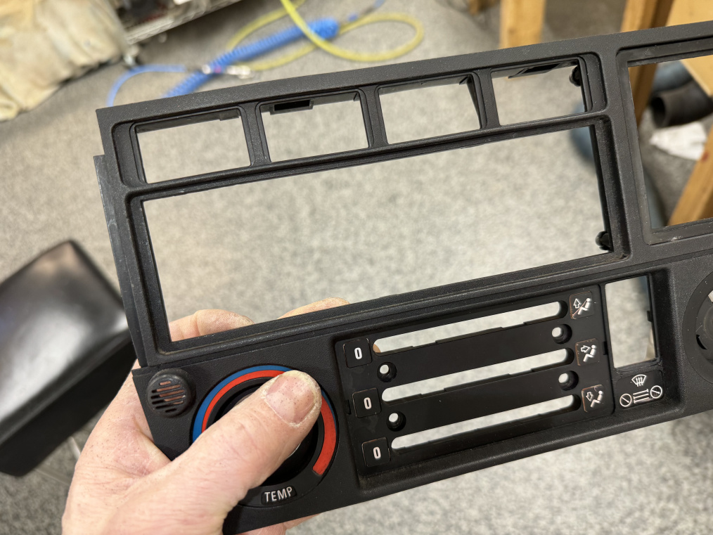

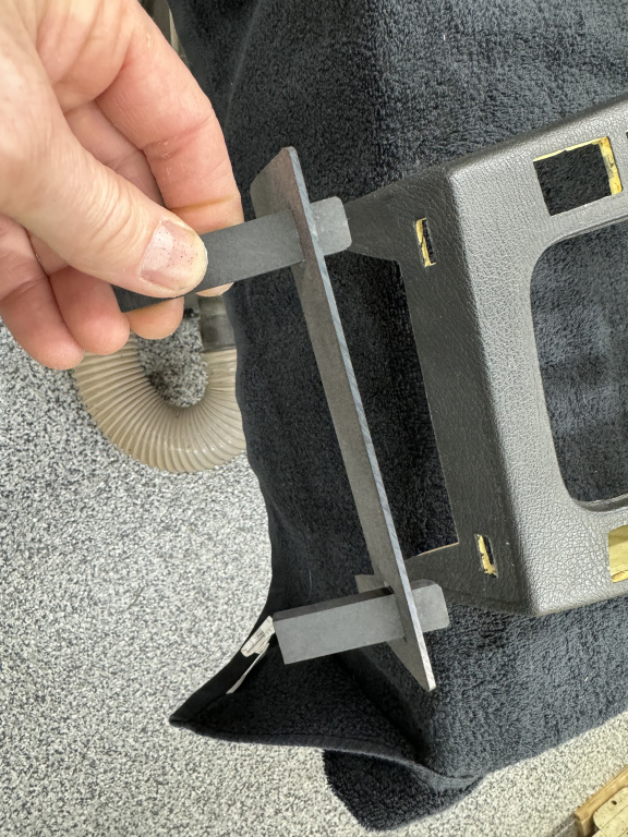

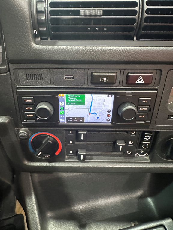

      I really like the radio, but I don't love how the headunit sticks out 1/4" of an inch from the rest of the dash.
      Custom made bracket to hold the aftermarket radio:
Name:	Photo Feb 06 2024, 2 52 22 PM.jpg
      From the backside:
Name:	Photo Feb 06 2024, 2 52 59 PM.jpg

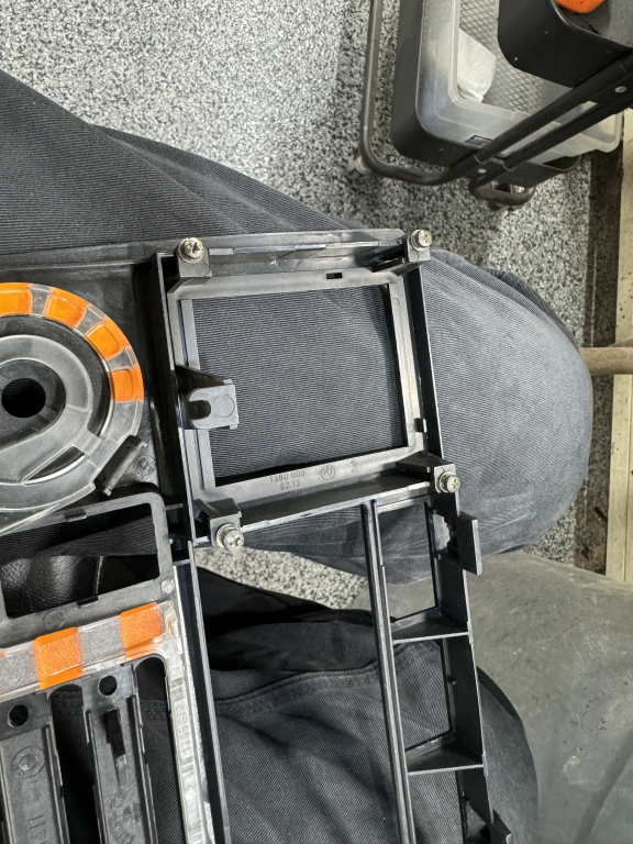

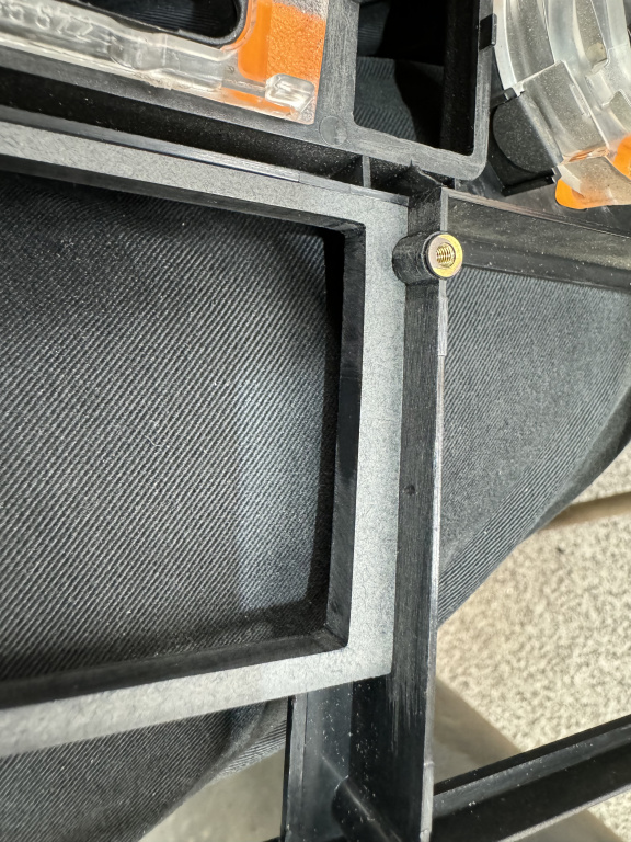

        backside of the radio frame showing the holder for the clock:
        Click image for larger version  Name:	Photo Feb 06 2024, 12 09 50 PM.jpg Views:	49 Size:	251.7 KB ID:	10113919
        ever-so-slightly trimmed the lip on the inside:
        Click image for larger version  Name:	Photo Feb 06 2024, 11 28 28 AM.jpg Views:	49 Size:	282.1 KB ID:	10113920
        side view showing the headunit sitting flush with the bracket:
        Click image for larger version  Name:	Photo Feb 06 2024, 3 21 57 PM.jpg Views:	49 Size:	130.6 KB ID:	10113921

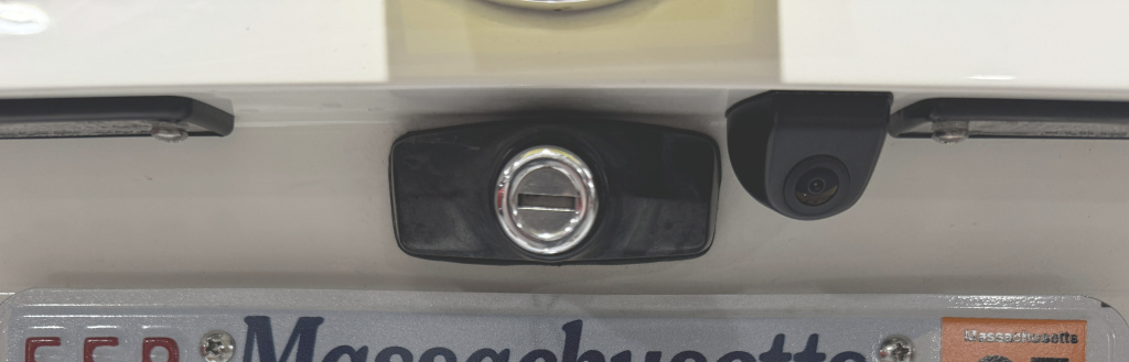

          reverse camera installed. Tight fit, but there was just enough space to fit it. SIngle hole drilled through the trunk to fit it.

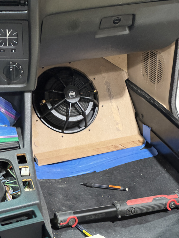

          Test fitting the custom subwoofer enclosure.
          Click image for larger version  Name:	Photo Jan 22 2024, 1 01 01 PM.jpg Views:	55 Size:	259.3 KB ID:	10113626
          Click image for larger version  Name:	Photo Jan 22 2024, 1 22 25 PM.jpg Views:	55 Size:	186.1 KB ID:	10113627
          Click image for larger version  Name:	Photo Jan 22 2024, 1 03 59 PM.jpg Views:	56 Size:	195.4 KB ID:	10113628

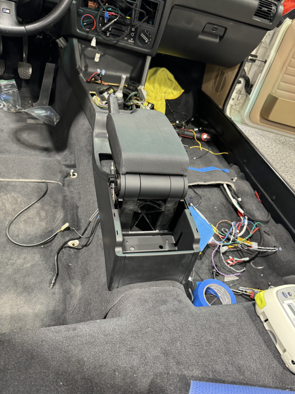

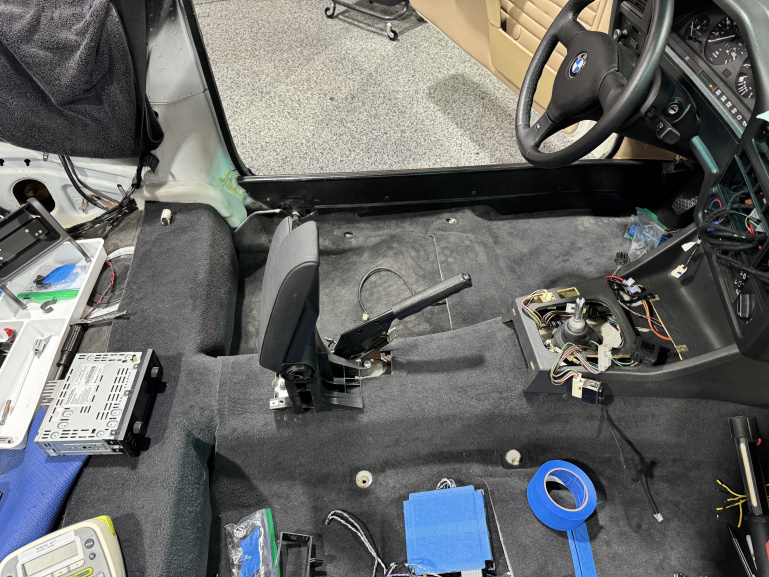

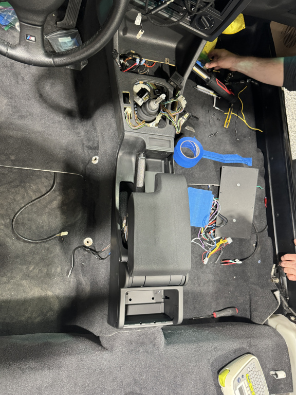

          Test fitting the e46 armrest and cupholder.
          Click image for larger version  Name:	Photo Jan 22 2024, 1 21 52 PM.jpg Views:	64 Size:	230.7 KB ID:	10113625

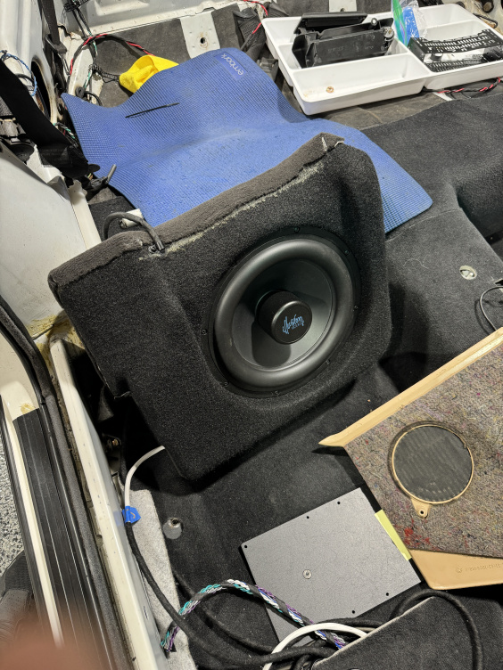

            Subwoofer box assembled and covered. Coming together beautifully!

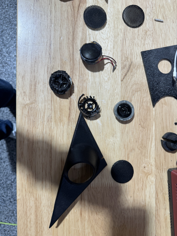

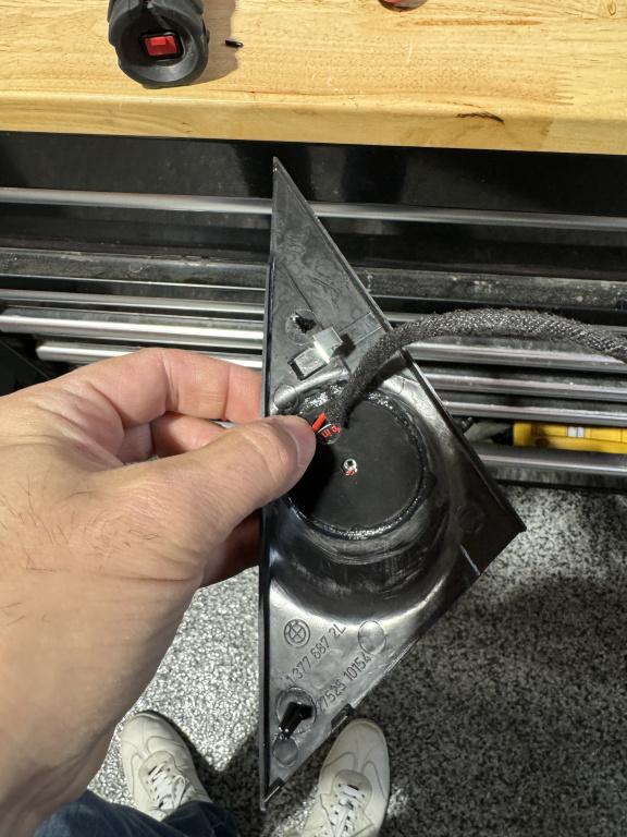

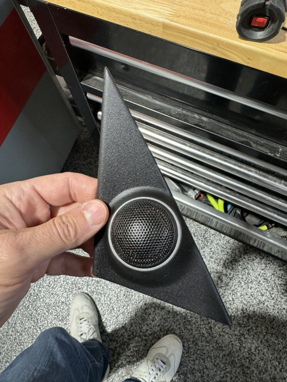

              Installing the front tweeters... My old stock tweeter housings where cracked, so I ordered a new pair. Unfortunately, you can't buy the brackets alone, you have to buy them with the factory speakers in them. Had to removed the glue delicately and preform some surgery to get them out. Then the new tweeters are (of course) bigger some some decisions had to be made on design. We decided to have them protrude more on the outside (as opposed to recessing them more into the door). They should sound better this way. NOTE: This is the only place where we will reuse the factory speaker wire, as it is in good shape and the molex connector passes through the door.
              Tweeters are part of the Audio Development 5 1/4" component set.
              65131377687
              65131377688
Name:	Photo Feb 01 2024, 11 35 05 AM.jpg
Name:	Photo Feb 01 2024, 11 32 51 AM.jpg

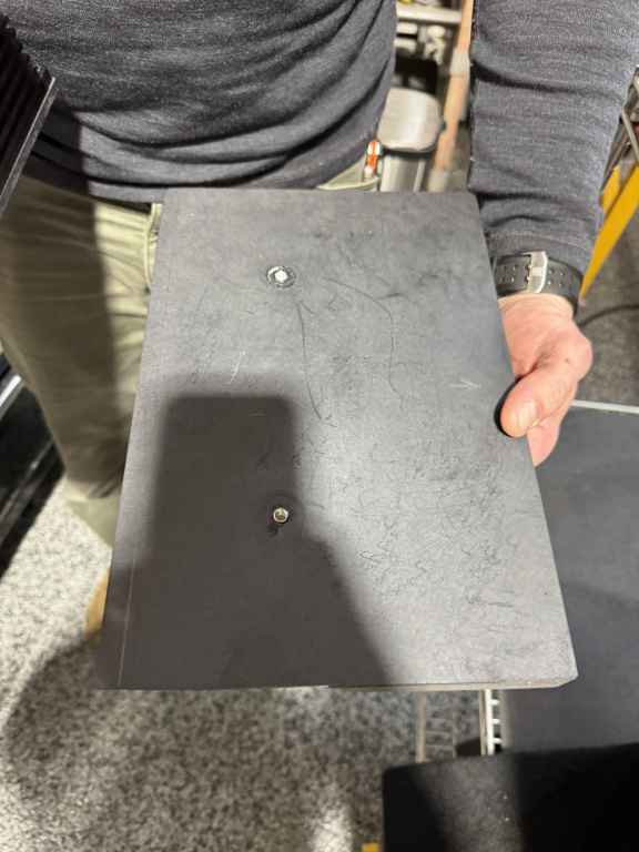

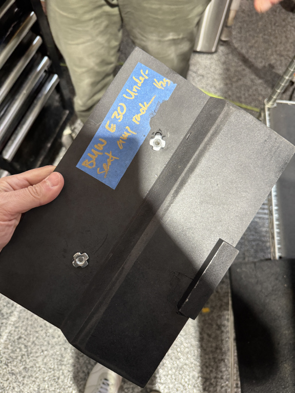

                Amp rack progress. This rack will be installed under the passenger seat. The base is made to follow the contour of the floor. The floor has been coated with Dyanmat, and the base will be attached to the floor with silicone. The top of the base will be installed on top of the carpet and will bolt into to the bottom of the base with 2 small holes cut into the carpet. No holes will be drilled into the car.
                This side face down and will attach to the Dynamat on the floor:
Name:	Photo Feb 01 2024, 11 50 50 AM.jpg
                Top of the bracket that will sandwich the base to the carpet., This will be finish paint/carpeted.
Name:	Photo Feb 01 2024, 11 50 41 AM.jpg

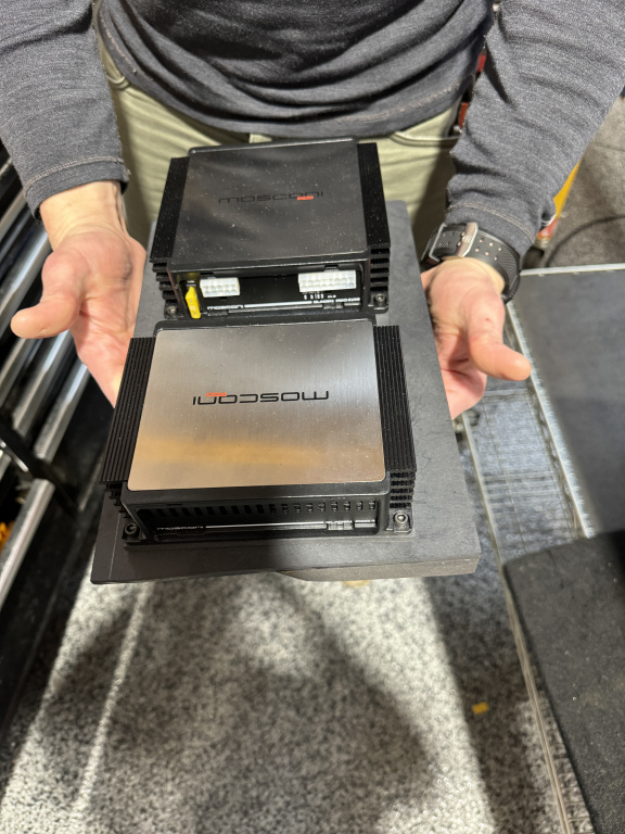

                Test fitting the two Mosconi amps. These things pack a ton of punch for such little amps. I have the same setup in my e46 convertible and they're amazing.
Name:	Photo Feb 01 2024, 11 50 27 AM.jpg

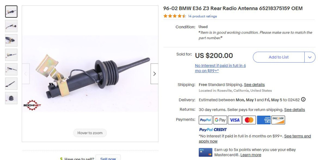

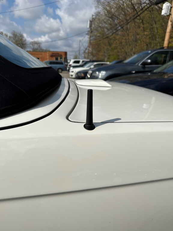

                  E36/Z3 antenna base and the e46 sport antenna. Still functional, OEM, looks way better than the always broken automatic antenna..
                  I bought this one used on ebay...
                  Click image for larger version  Name:	ebay.jpg Views:	0 Size:	132.8 KB ID:	10113648
                  ...and then attached the OEM e46 sport antenna. This one I ordered new. Screws right in:
                  Click image for larger version  Name:	2.jpg Views:	0 Size:	108.2 KB ID:	10113649
                  While I was replacing the antenna, I added keyless entry... It connects in the trunk, so was a good time to connect it. Can't believe how cheap this mod was. I used the Proline REC-43T. $39 on Amazon, and followed these instructions.

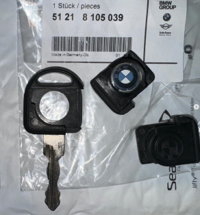

                  I also replaced the flashlight on my key. Who knew this could be replaced?! Nice touch, flashlight actually works--I didn't even realize there was one there. Part # 51218105039. $27 well spent.

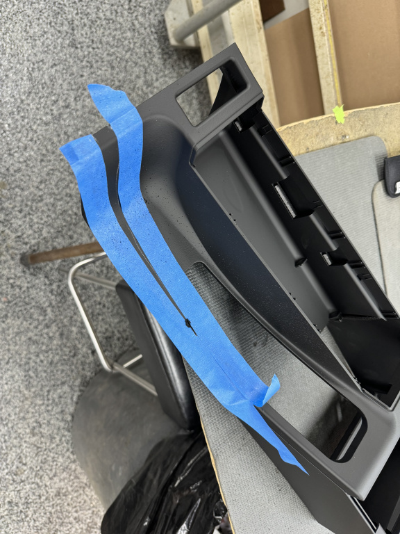

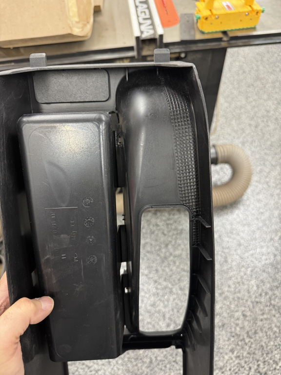

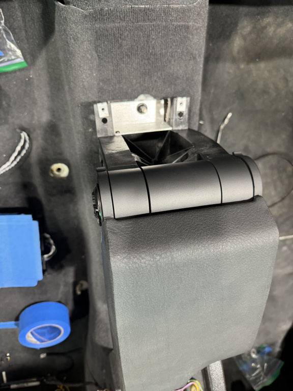

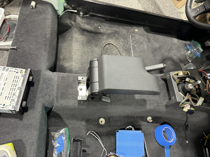

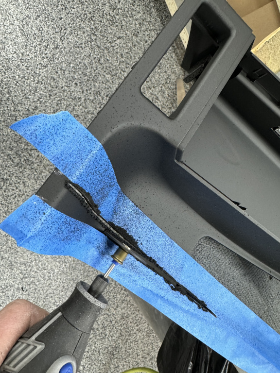

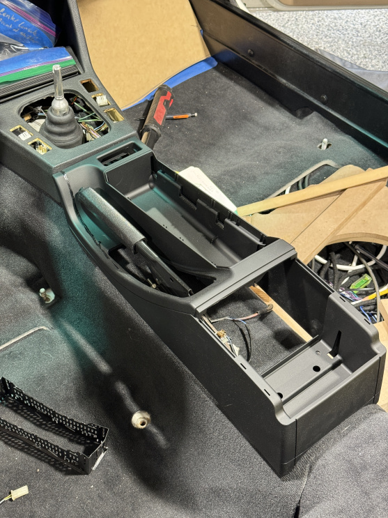

                    Some updates on the custom arm rest and center console progress. The e46 armrest is wider than the e30 center console so it needed to be trimmed to fit. We are going to use the space where the hazard switch was to install the bass knob for the subwoofer.
                    Click image for larger version  Name:	Photo Jan 17 2024, 12 21 41 PM.jpg Views:	0 Size:	204.4 KB ID:	10113927
                    Click image for larger version  Name:	Photo Jan 17 2024, 12 23 08 PM.jpg Views:	0 Size:	255.7 KB ID:	10113928
                    A special bracket was fabricated at the front of the arm rest to snap into the e30 mounting locations.
                    Click image for larger version  Name:	Photo Feb 07 2024, 9 18 28 AM.jpg Views:	174 Size:	263.1 KB ID:	10113935
                    Then the bracket was attached the trimmed bracket:
                    Click image for larger version  Name:	Photo Feb 07 2024, 3 22 03 PM.jpg Views:	174 Size:	163.6 KB ID:	10113936
                    Click image for larger version  Name:	Photo Feb 07 2024, 3 22 26 PM.jpg Views:	173 Size:	163.1 KB ID:	10113937
                    1992 318i cabrio Alpinweiss 2
                    2006 ZHP cabrio Imola​
                    • sna77
                      • Apr 2023
                      • 206
                      No hole were drilled to attach the arm rest to the car. An L bracket was fabricated and a longer bolt was attached to the stud
                      Click image for larger version  Name:	Photo Feb 07 2024, 3 40 32 PM.jpg Views:	0 Size:	291.6 KB ID:	10113930
                      The second mounting point uses the ebrake bolt. The arm rest isn't going anywhere!
                      Click image for larger version  Name:	Photo Feb 07 2024, 3 40 28 PM.jpg Views:	0 Size:	262.7 KB ID:	10113933
                      Test fitting it all together:
                      Click image for larger version  Name:	Photo Feb 07 2024, 2 32 04 PM.jpg Views:	0 Size:	227.3 KB ID:	10113934

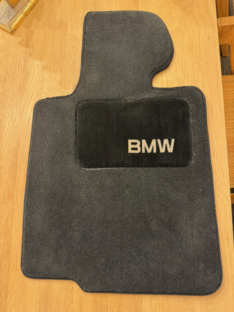

                          Can you explain what the difference is between the carpets? (51471942689 & 51471942691​)

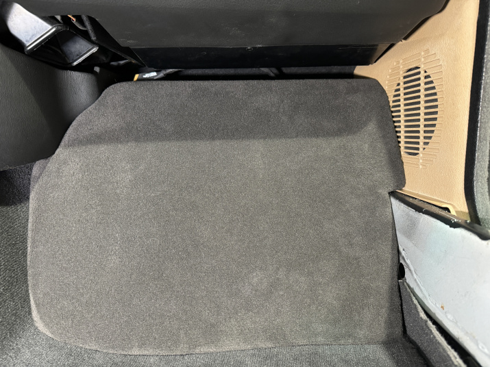

                            The carpet is 2 pieces. The expensive one is the main carpet, the cheaper one is the one that goes vertical where the rear seats are.
                            I drew a circle around the 2 pieces:

                              Also, I'm super interested in the E46 armrest and cupholder. This is probably the thing I'm most interested in for my car.
                              Thanks!
                              So the arm rest is a TON of work. I got the inspiration from this DIY:
                              The shop I’m using wanted to do it a bit differently—so I told them to have at it however they wanted to do it…
                              Super excited to see the results in a few weeks. Waiting on the seats to be redone so I can put it all back together
