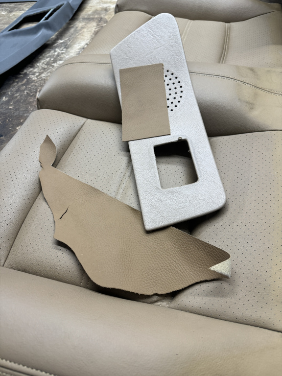

      Thanks! I dropped the seats off in CT the other day at Prestige Auto Upholstery to have them redone. Going with BMW oem color (from e46 generation) natural brown.
      Here’s the sample vs the plastic trim:
        So are you doing a two tone interior? Natural brown seats with black door panels?
          Carpet, dash, center console in black. Everything else in natural brown

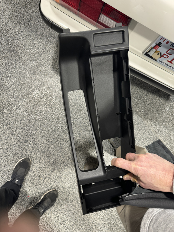

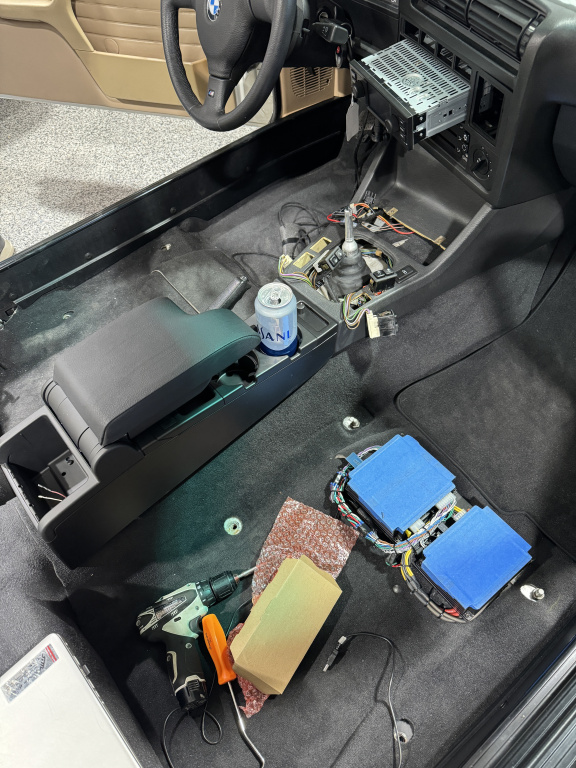

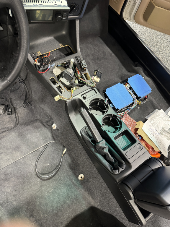

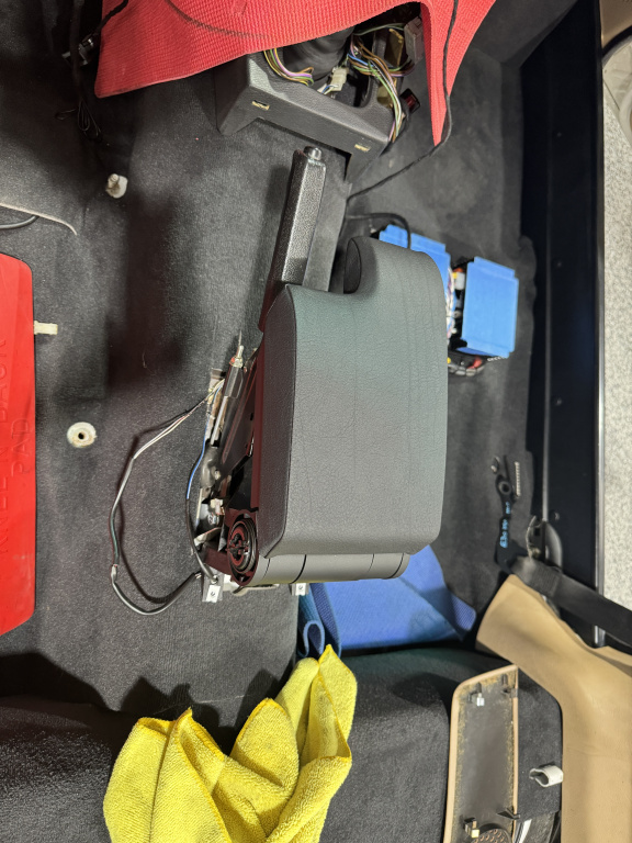

            Back to the audio... Stopped by the shop to check on progress.
            The first coat of paint is on the e46 armrest. The hazard switch spot will hold the subwoofer control knob.
            The Mosconi amps have been mounted under the front passenger seat. Some painters tape to protect them while waiting for the seats to return.
            Arm rest fitted nicely--the thing is solid. Doesn't move at all.

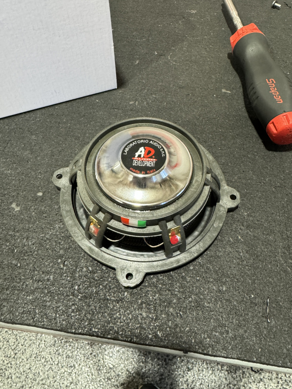

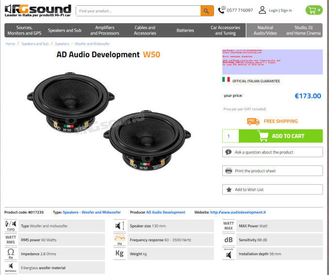

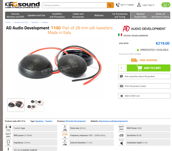

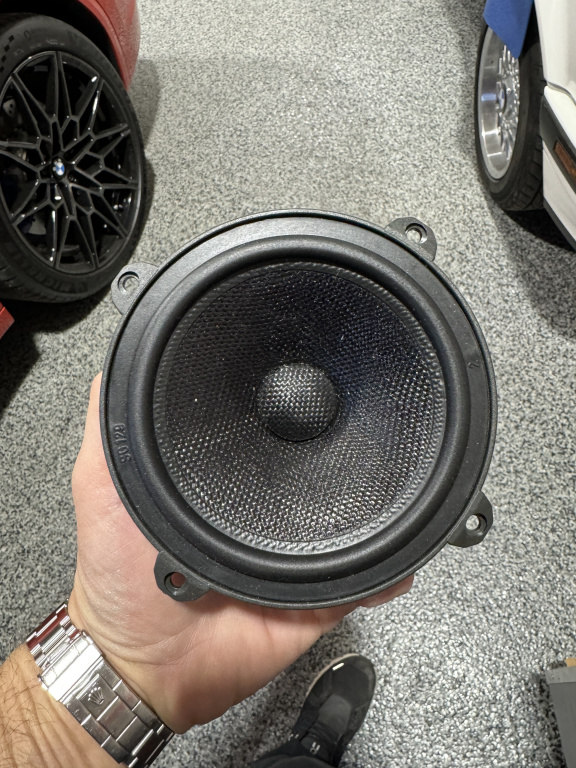

              The speakers have all arrived from Italy. Here are the details--all Audio Development.
              The fronts are true separates--there will be an active crossover done in the DSP in the Mosconi 6|8 (6 channel) amp.
              Front tweeters = Audio Development T100
              Front 5 1/4" midrange = Audio Development W50

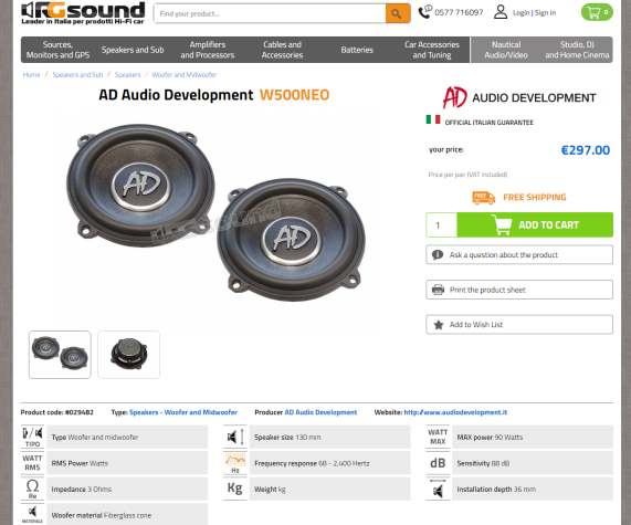

              Rear 4" = Audio Development W500NEO
              If the magnets look small, it's because they are neodymium magnets. We chose this line of speakers specifically for the quality and neo magnets to accommodate the shallow enclosures of the e30 without heavy modifications that would have been required to fit the Focals...
              Front W50 Midwoofer:
              Click image for larger version  Name:	IMG_5064.jpg Views:	0 Size:	271.5 KB ID:	10114484
              Click image for larger version  Name:	IMG_5063.jpg Views:	0 Size:	260.5 KB ID:	10114483

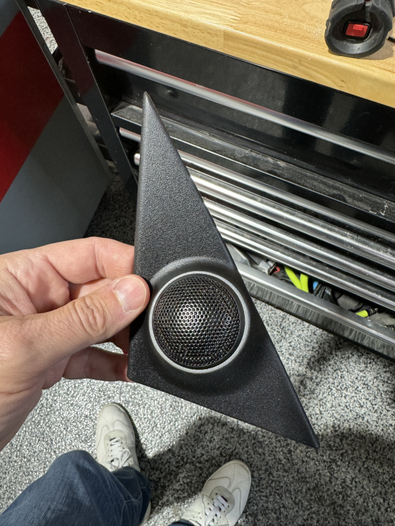

              Front T100 tweeters installed in the OEM tweeter bracket:
              Click image for larger version  Name:	Photo Feb 01 2024, 11 32 48 AM.jpg Views:	0 Size:	239.8 KB ID:	10114487
              Tech specs on the speakers:
              Click image for larger version  Name:	T100 tweeters.png Views:	0 Size:	171.1 KB ID:	10114485
              Click image for larger version  Name:	W50-translated English.png Views:	0 Size:	161.3 KB ID:	10114486

                and the rears:
                Click image for larger version  Name:	W500NEO.png Views:	3 Size:	164.0 KB ID:	10114494

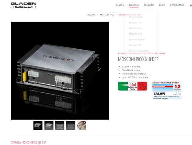

                Mosconi Pico 1 (subwoofer) amp:
                Mosconi Pico 6 | 8 6-channel amplifier:

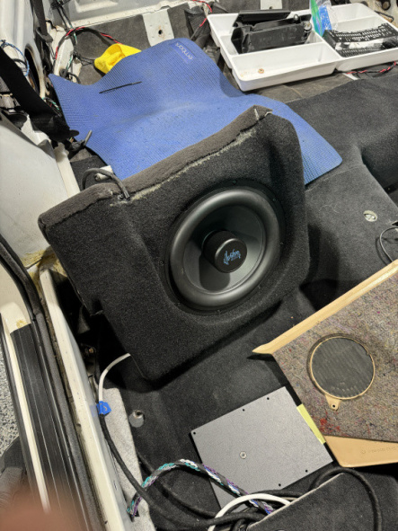

                  What subwoofer are you using and were are you installing it?
                  • sna77
                    • Apr 2023
                    • 206

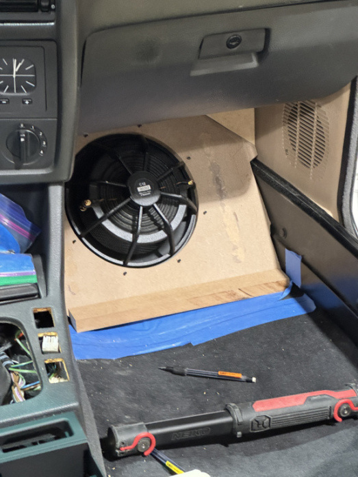

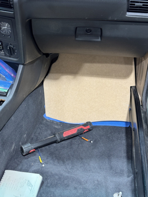

                    Illusion Audio C10 shallow subwoofer. The install shop is building a custom footwell subwoofer in the passenger footwell. They do this all the time for old Porsches and did one for my e46 convertible. Huge difference over putting it in the trunk... This is the only sub that they use for the footwell applications--years of trial and error to find the best down firing sub for a shallow footwell.
                    Here are some test pics so far. They're rewrapping it now as they weren't happy with how the black matched:
                    Test fitting the sub.
Name:	Photo Jan 22 2024, 1 03 54 PM.jpg
                    Initial wrapping:
                    1992 318i cabrio Alpinweiss 2
                    2006 ZHP cabrio Imola​
                    • sna77
                      • Apr 2023
                      • 206
                      and finished product. They angled it higher than they usually do so as to not block the sound from the footwell speaker. The floormat will cover this --you won't even know it's there...
Name:	Photo Feb 02 2024, 12 05 55 PM.jpg
Name:	Photo Feb 02 2024, 12 05 43 PM.jpg

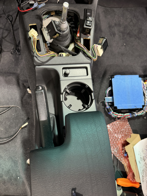

                        Some updated pics on the center console / armrest. The bass knob for the Mosconi amp has been installed where the hazard switch was.
Name:	Photo Feb 19 2024, 2 50 30 PM.jpg
Name:	Photo Feb 19 2024, 3 41 55 PM.jpg
Name:	Photo Feb 19 2024, 2 51 23 PM.jpg

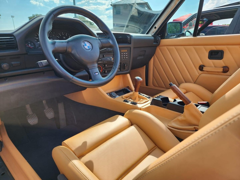

                          I saw these picture online today and fell in love... I think I'm going to do a two tone interior with black and natural brown. I'll already have the black carpet installed, so will wrap the door panels, trim, and tonneau cover in black with natural brown inserts.
                          Ha yup that's why I asked, like e46 interior. I opted to keep the seat back black when I did mine.
